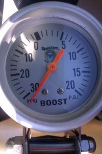

i just remembered that i had a old boost gauge that also reads vacuum in InHg ( inches of mercury ) so i hooked it up and its reading at 30InHg , but im not 100% sure what its ment to be at but that seems rather high , so it could be possible that my vac pump is stuffed and sucking the pedal to the floor and when i pump it its using the vacuum and making the pedal firm until i stop pumping ? i have attached a picture as well so you can see the gauge reading for yourself, let me know what you think ?
cab+rider
On a gasoline engine idling at 600 rpm the reading is 17 in.Hg.
At a 1000 rpm it's about 20 in.Hg.
You did mention you're waiting on a gauge tester maybe compare readings first and go from there.
Does the Brake Booster have a check valve in line with the vacuum hose?
aaron001au
it dose have a little one way valve in it , i hooked up the gauge sat in the cat and pumped the pedal and it dropped a fair bit after 2-3 pumps it was down to about 10in.Hg. and it was rock hard and at about 15in.Hg. it was a nice firm pedal
