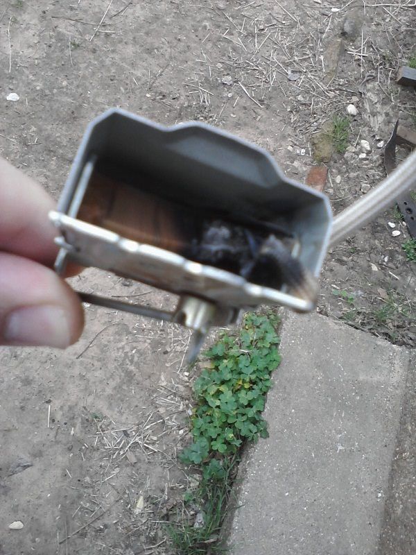

Trying to figure out why my gas level isn't working I find that the float level arm in the fuel sending unit is burned, how did this not catch fire inside the gas tank? I started checking out how much it would cost and seems like Mazda sells the arm by itself for $120. Anyone have any idea where else I could get this? Maybe replace the whole fuel sending unit? I tried looking online but most of the ones I see don't have a fuel pump or any place to put one.

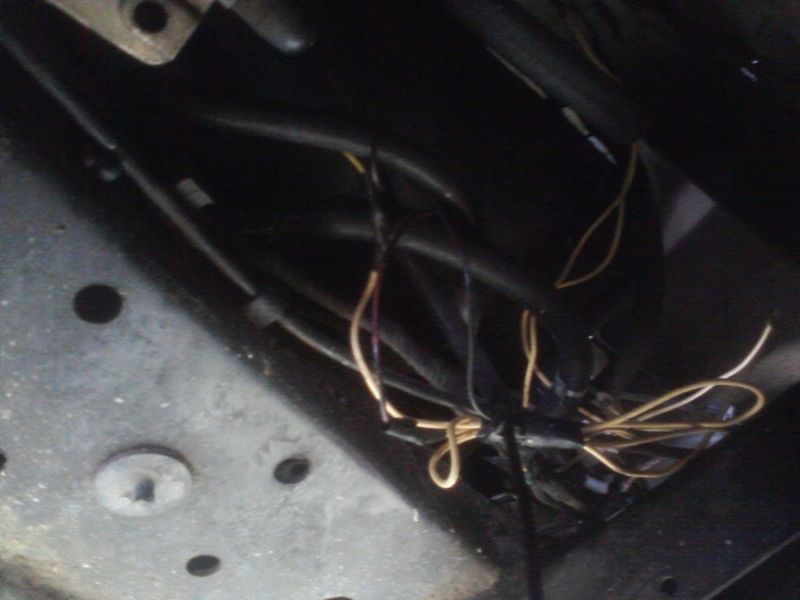

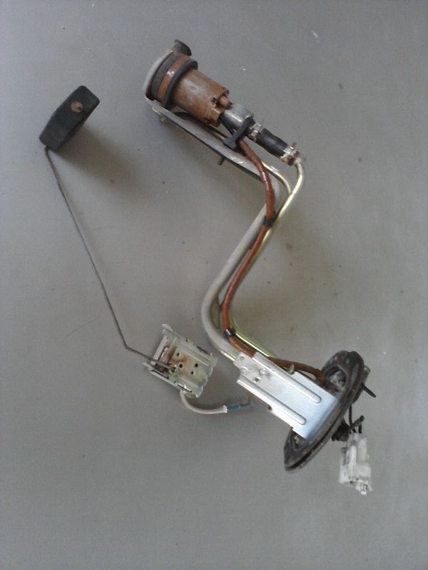

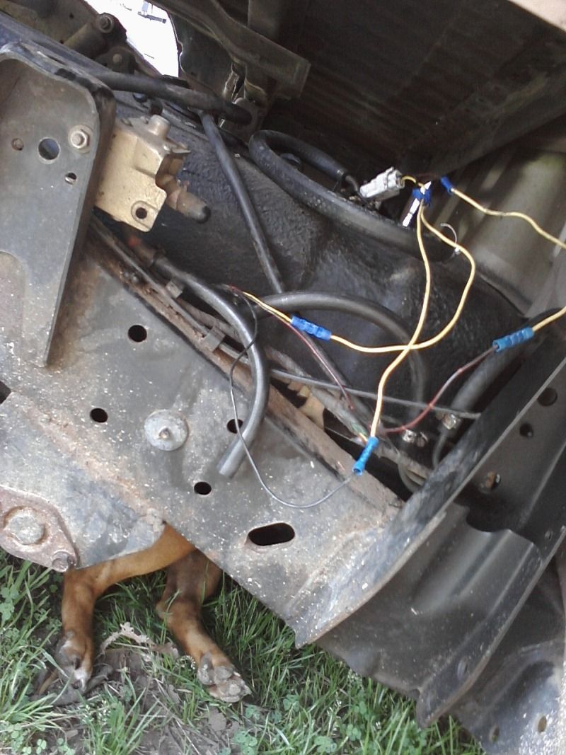

Well, went ahead and bought the part here, had to return 2 of them. Turns out this whole part isn't really from this truck it seems. So on the third part they ordered over at Mazda I get the right one and install it. Try to first turn it on and still guage isn't moving. The wires coming from it were actually spliced for some reason and I took off all the take and extra like 2 feet they had on these wires. I added a picture of what I had seen a while back (didn't know what all the wires were at the time) and what it looks like now.
How do you go about testing the guage in the truck first? I am thinking it might be a ground issue right now but guess I have to start at the guage.

Make sure they know at the dealer..that's a different sender entirely...and you should be able to get the fuel gauge sender separate..last I checked they were around $60
blind123
Yeah, first two ordered were supposed to be for the truck but they weren't, got it right on the third time. First one was $80 here and the other two were $100...so, kept the last one but still trying to figure out whats wrong with this.

Damn.. most of your problem is most likely the wiring if it still doesn't work.. the plugs like to corrode and come apart and guys splice in whatever they can to make it work..the gauge runs off resistance and adding butt connectors changes it a bit..got access to another rear harness to plug it in and see if if works?
