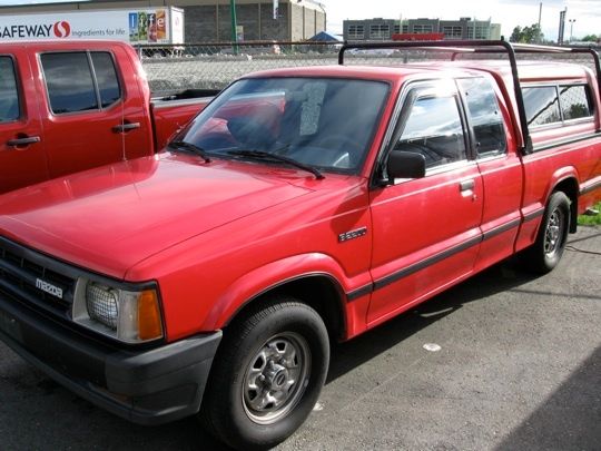

Hi! This is my first post here. I've spent the past two weeks trying to solve an engine problem and haven't made much headway so far. I've spent a lot of time searching the web and have acquired a Mitchell's manual.
My truck is a 1992 B2200 (EFI - fuel injected) with 149,000 kms (92,584 miles)
At first, power would cut out - the gas pedal would be unresponsive and the engine would stall randomly (when driving uphill, downhill, or on flat ground). I could idle the vehicle for about a minute and the power would return and drive fine though... until power cut out again.
That was then. Currently, it starts and idles okay but doesn't respond to throttle input. When warmed up, it runs rich, producing black smoke out the exhaust and has no power when trying to drive it - I can barely get it moving. The only way I can move it is to put it in first gear or reverse and drive it with the clutch half-out (not using the gas pedal at all).
The check-engine light (MIL) never lit up and the truck displays no self-diagnostic codes. The MIL is not burnt out and the rest of the indicator lights are also good.
