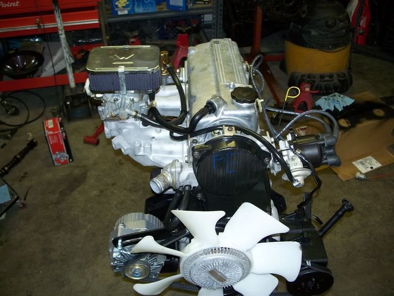

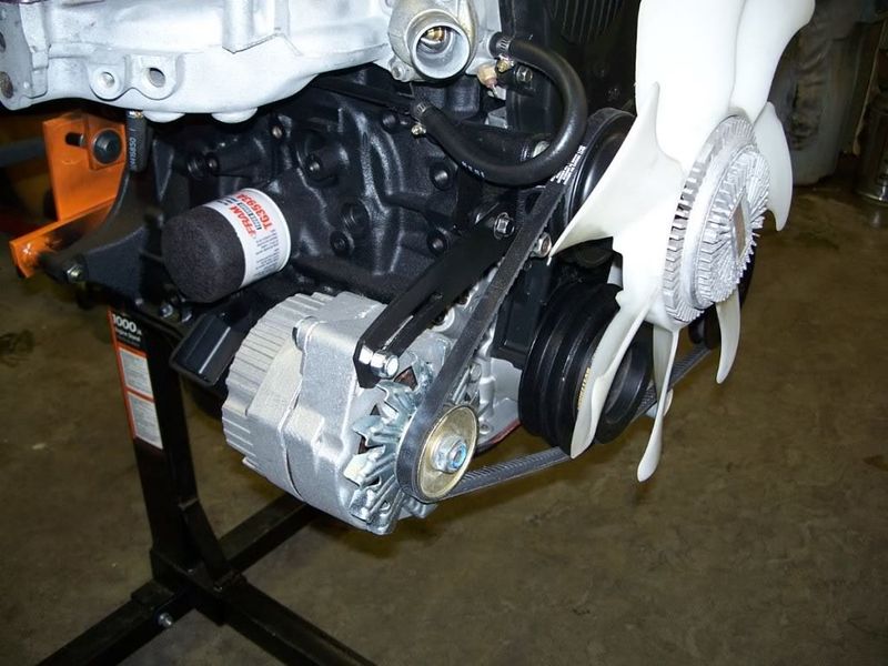

Im not to sure if they make higher amp stock alternators off the shelf for our trucks, I do know you can get one custom wound to higher amp though. I know you dont want to modify, but I put a 100 amp One Wire GM alt on mine, it was super easy swap. Just giving you some options. Also I think you can swap some Ford alt but I dont know the details of that swap. Heres a couple pics of mine before the engine was installed.

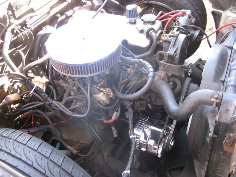

Here is mine and i think it is a good idea... but i got the idea from this site... i have a couple amps 2 optima yellow tops and 2 compressors and havent had a problem

I've never had a problem with mine, and I have over 25,000 miles on it. Its kinda bolt on, you need a 5/16 thread bolt about 1 inch long for the bottom, and the top is a 3/8 thread bolt around 3 1/2 (I cant remember the length). As for the belt it took me a couple trips to the parts store to get it right. If you need to I can get the number off my belt.
