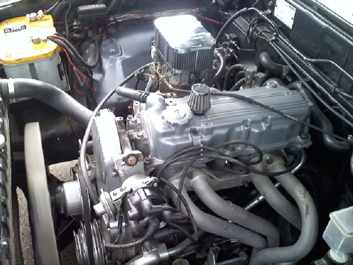

Here is a picture of the engine bay..unfortunately the coil isn't in this picture.. I can't get a picture right now cause the truck is at the local Advanced Engines shop. When i originally replaced the stock coil with the accel coil I put a two way male terminal connector on the positive side of the coil and hooked the two blue wires coming from the distributor to the positive side connector and I hooked the yellow wire thats connected to the core suppurt to the negative side of the coil. Does this make any sense? How is the stock coil hooked up?

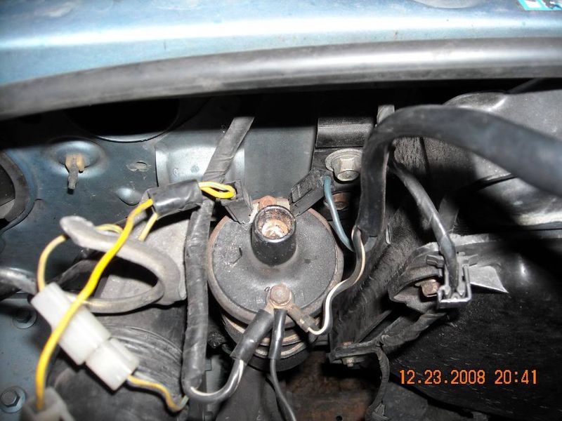

I found this picture of a stock mazda coil hooked up online.. Is this the same way you hook up the accel coil ? Please help

Yeah, thats the correct way to install the coil.
Nice engine by the way

The negative and positive wires that connect to the coil were hooked up opposite of how it should be. I removed the coil and installed a new one with the wiring connected correctly. The problem is solved. Thanks for ALL your help.
