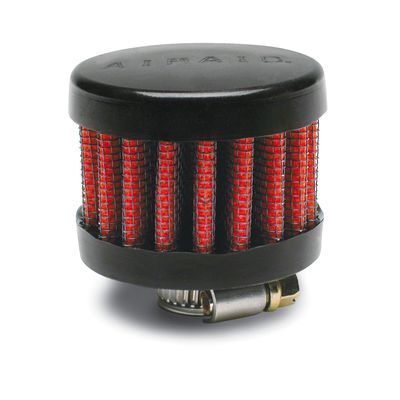

mine did the same thing. you can put a small breather filter right there to help
90-b22dawg [andrew]'s avatar
90-b22dawg [andrew]
you can get one simiular to the one below at your local auto parts house
