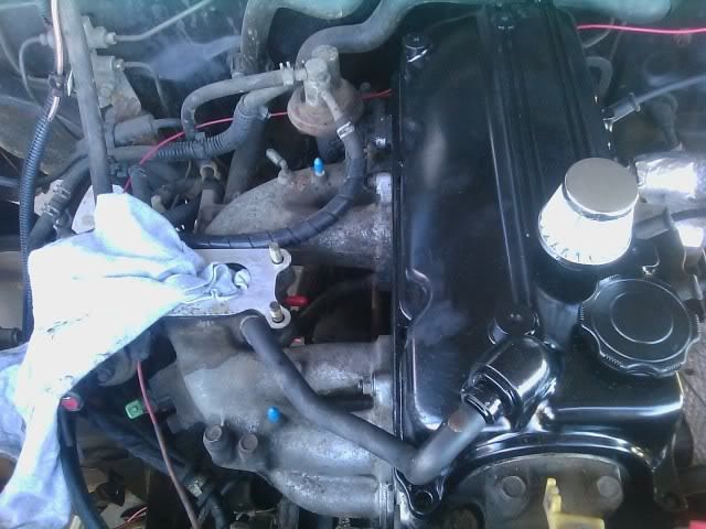

hey guys im installing a 32/36 weber on my 89 b2200 and was wondering if i needed to put a fuel pressure regulator or not how can u tell if ur fuel pump is manual or electric?? thanks
hunterw's avatar
hunterw
the manual fuel pump is at the back left of the valve cover. like in the pic

and if you have a mechanical you shouldnt have to put a regulator on there
8
808mazdawg
yeah mine looks like that guess i got manual then thanks alot man!!

Stock fuel pump puts out about 6-7 psi. Weber recommends 2 psi with a 3 psi max. You WILL need a adjustable regulator. I run mine at 2.5 psi with good results.
