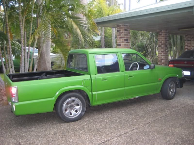

recently picked up a 91 dually b2600, but have noticed that the gear shifter is quite sloppy and loose. Any suggestions on what might be the cause? simply wear on the shaft or something more sinister?
Its been a while since i have had a floor shifter, the 84 isuzu / rodeo i have is column shift,so not sure how tight these things should be.
Cheers and heres a pic of work in progress
First welcome to the site! Can you make a thread showing your crew cab? We don't get to see many if any at all in the states
