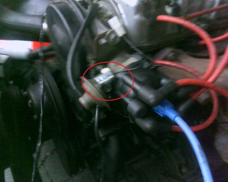

What does this thing do? circled in red.
Changed everything and still no spark. please i need help asap

Looks like a condenser to me, normally they are situated on the side of the dizzy itself.
If it is the condenser it works like a capacitor in a car stereo, holds a bit of a charge for when it's needed.
Normally you would replace them whenever you do the points and plugs, also just so you know coils are oil filled and don't usually like being heated up which is why it's unusual to see one mounted to the block like yours.
I'd check that too, just to make sure it's not just a dead coil.

cheers dev. its a brand new coil. Thought the old one might be the problem. but i'll mount it somewhere else. and yea i have a condensor up next to the dizzy, a little silver one.
but not sure wat this is, It has a wire that goes from the coil, into it, out of it and up to the points
anyone else???

it was a noise deadner for the radio, not sure if it was makeing my ute run like shit or not but i ran some new wire and by passed it. ute runs mint now
mazdatweaker
That is the condensor. And if you take it out of the circuit entirely, you will burn up your points, because it is designed to buffer current.
If it has gone bad, it shorts internally, so the coil doesn't get charged properly.
The other thing you think is the condensor is more likely the RF capacitor. It's there to cut down on radio interference (hash noise)

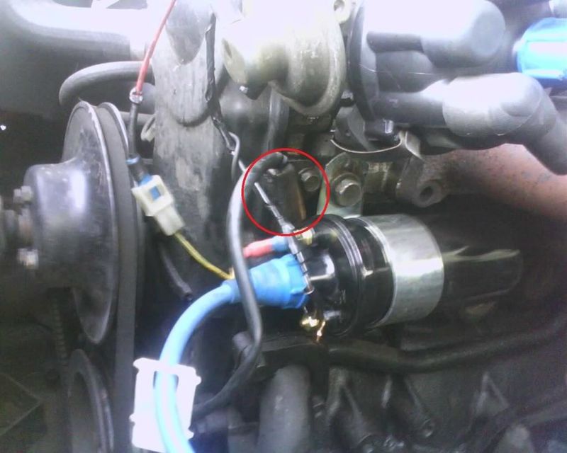

this one here is the condensor
sorry bout the crap picture. I change this everytime i change my points
