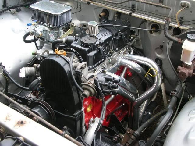

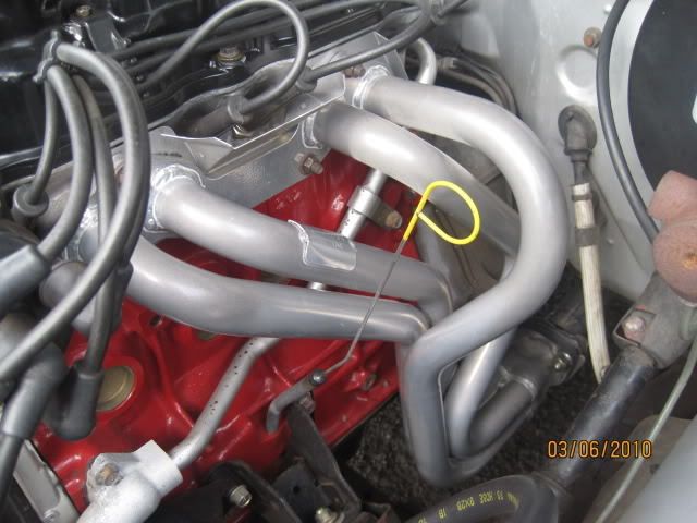

I know most of you have 2 1/4 exhaust pipe but will this be too big with my automatic tranny? I do have headers and a 32/36 webber.Should I just go with 2 in.

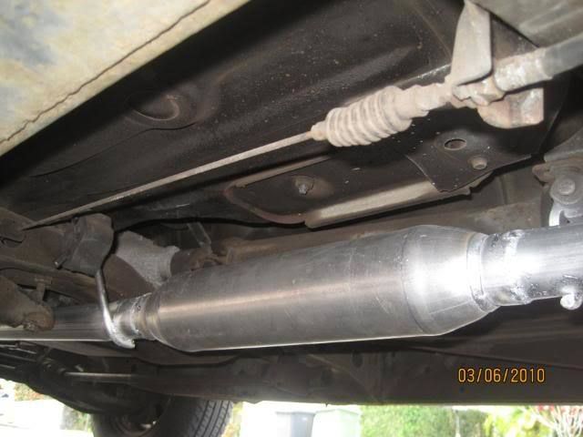

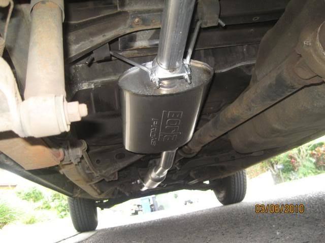

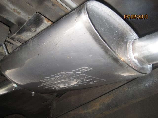

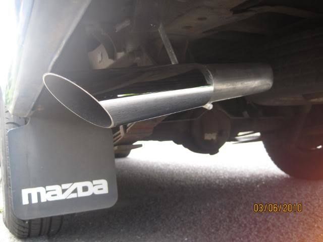

Got my exhaust done. I went with two inch pipe from the header to a resonator and to a 2 1/4 borla pro xs and tail pipe. I went smaller in front just to keep some presure in the system. A larger tail pipe gives it a deeper melow tone too. The sound is just what I was looking for. Its not loud at all. kinda low and mellow and no freeway drone. Actually preety quite on the freeway. I'll post some pics later.

hawaiian

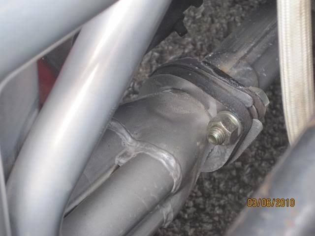

had some flages put on for easy removal
resonator in place of cat to help reduce that 4 banger ricer wraspy sound

Looks nice!! I have an 89 automatic mazda. I did the same thing as you did but I didnt run a cat. Just had a straight pipe to my flowmaster muffler then dumped out the muffler with a downturn.
hawaiian
I have no cat too. that long tube looking thing is not a glasspack, its a resonator to tone down that high raspy sound when you floor it.
