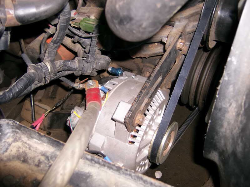

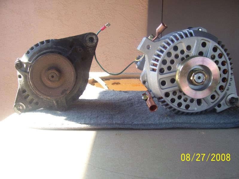

here is a pic of my old 250 amp alty from mechman......
next to the stock one lol.
installed.(tight fit)
