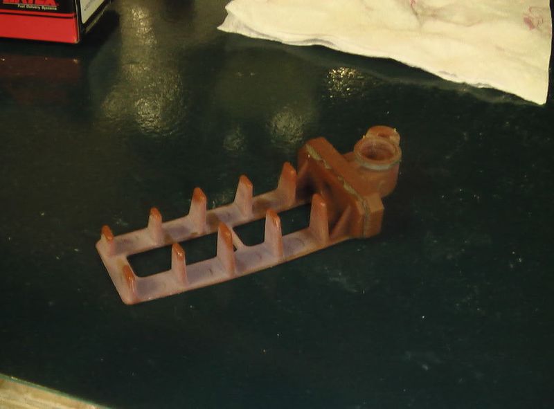

SinCity you called it. pulled it apart and found this
this is whats left of the sock. A big chunk of it was clogging the the inlet on the fuel pump. I wonder how the damn thing was even running in the first place.
Already blew out all the lines and inline fuel filter, replaced the sock. Got her together and runs SOOOOOO much better then when I even brought it home.
