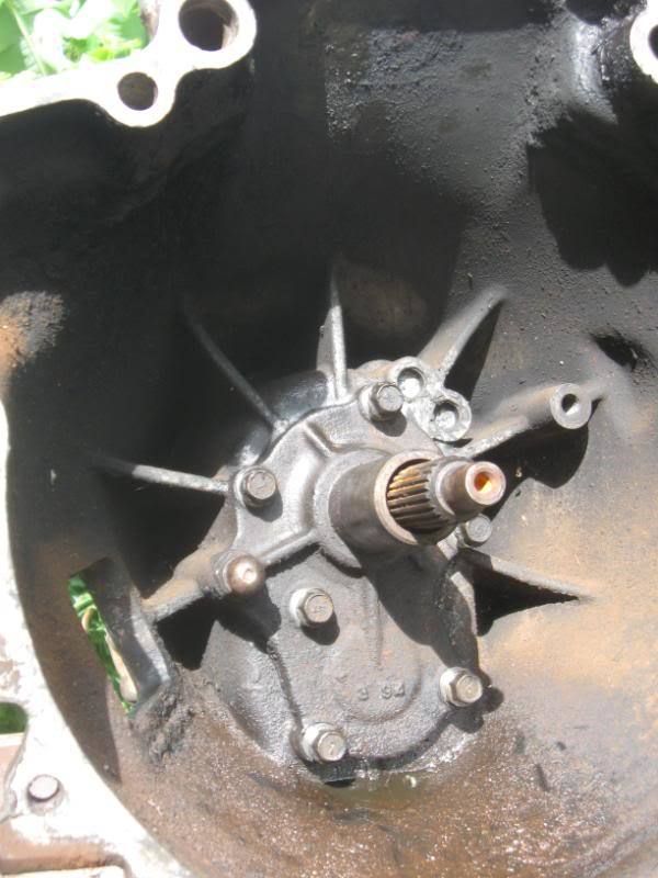

my dog mulched mine while i was gone and need to get my trans back in
i need the torque specs for:
driveshaft to diff-
trans crossmember-
trans mount to crossmember-
trans to engine-
and in the pic, the input shaft cover bolts specs
thank you thank you, need em asap, thanks
drive shaft to diff- 36-43
trans cross-member-install the cross-member and transmission support. Tighten all Nuts and Bolts Securely
trans mount to cross-member-
trans to engine- 51-65
On the bearing housing, it says that rebuilding a manual tranny is to technical for the do it yourself er go buy the trans rebuild manual specific to your vehicle..

i thought they would metion that housing cover, lame, they werent hard to break loose i'd guess around 20-25lbs-ft
