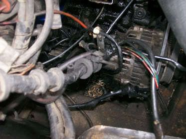

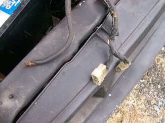

kinda hard to take pics of it, but anyways thats the black wire and 2 plugs that arent plugged in. the 2nd pic is the alt. and where they attatch to it. hope this helps. i would really like to get this fixed today if anyone can tell me where to plug them in at. thanks

the starter is plugged in? the big wire needs a loop connector and hooked to the stud on the alt. the larger plug into (if you were looking at the back side) 3 o'clock, the smaller at 6 o'clock
