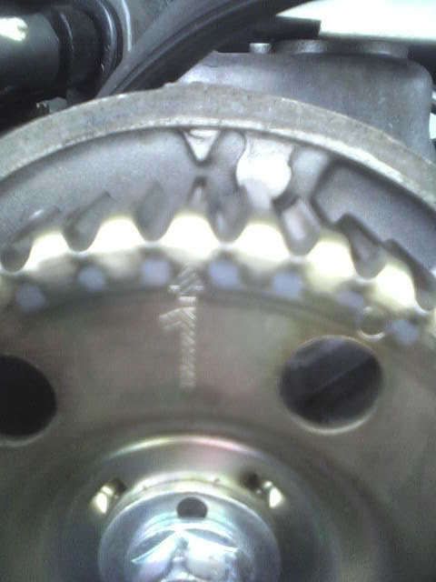

can anyone tell me on the top timing belt pulley is there a actual timing mark on there or the number 1 on that pulley it has 1,2,3,4 on the pulley?????? please help i bought the damn haynes repair book and it shows the older style with the timing chain PLEASE HELP THANKS
one_low_22
yes, if you look closely right above the number one there is a small arrow, might need to clean the pulley to see it, and there is another arrow that it should line up with on the engine, and if you have taken the pulley off, the pin on the cam should be put back in the hole thats closest to the number one on the pulley

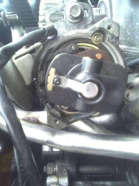

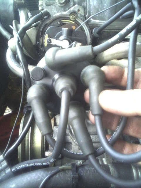

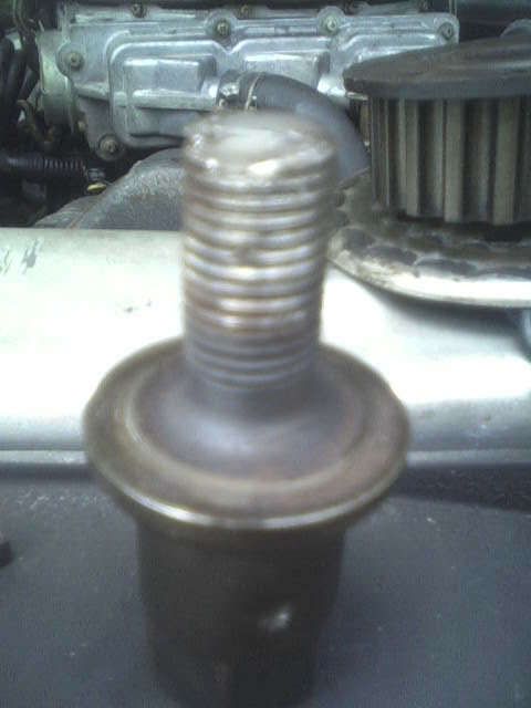

ok i found the arrow right above the number 1 i didnt take it off or anything i lined it up on to the arrow on the front of the casing and i was looking at the distributor and it looks like the rotor is pointing at number 2 instead of number 1 the crank shaft key is straight up also now the bolt that holds the crank shaft pulley on i think part if it broke off in the crank shaft?? it still has alot of threads on it but the end of it looks like it broke off or something i remember its not really long about 1.5inch of threads what should i do?? i dont want to take the crank out and replace it maybe its not broke off i donno could i weld that pulley on the crank???PLEASE HELP heres some pics of what im working with
(is the distributor pointing at 1)???
(i think the end of the bolt broke off how can if it is how can i get it out of the crankshaft i really dont want to weld the pulley on)

ok, the motor is at tdc for cyl #1, now if you pull the distributor out there is a small indentation on the gear, and there is an alingment mark on the distributor itself, line those 2 up and that will be pointing a to cyl#1.
now as for the bolt, yes it is broken, i wouldnt suggest welding the pulley to the crank, cuz i have to find a way to get it back off if you need to change your oil pump, timing belt, water pump, etc. just clean the end of the bolt up a little, like make the end smooth and put it back in and tighten the piss out of it

u think i can use a bolt extractor and get the broken piece out and go to the junk yard and get another crank bolt??? thanks again
one_low_22
if you have enough room to drill it and use an extractor id go for that then just replace the bolt, but i have to het off here pm me and ill give you my number if you have any further questions
