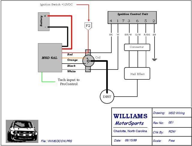

slamjammatt
here is this if it helps any
N
ncsfinest
thank you
slamjammatt
no problem
