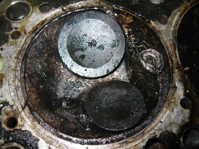

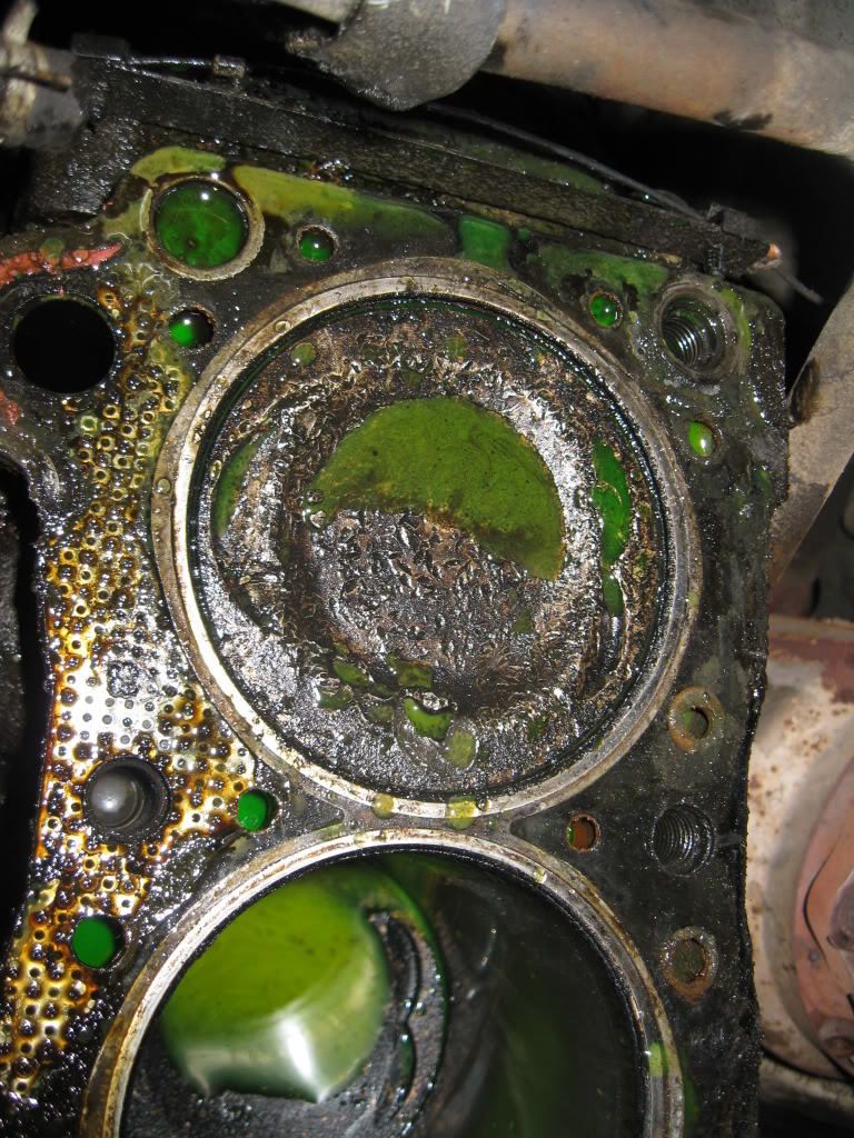

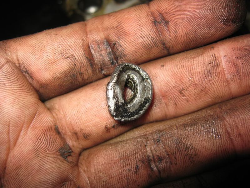

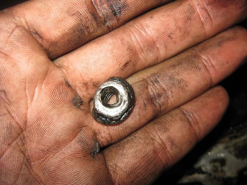

Great find today.... i guess a nut fell into the intake......... i don't recall any nuts falling unless it was in the carb when i pulled it off the other truck
looks like the washer/nut that holds the top of your air cleaner on...brolly went down the carb
suicide's avatar
suicide
damn that sux bro
mazdatweaker
At least you found the problem.
I could be wrong, and it wouldn't be the first time. . .but it looks like a valve cover holddown grommet.
Barely.
What are your plans at this point?
