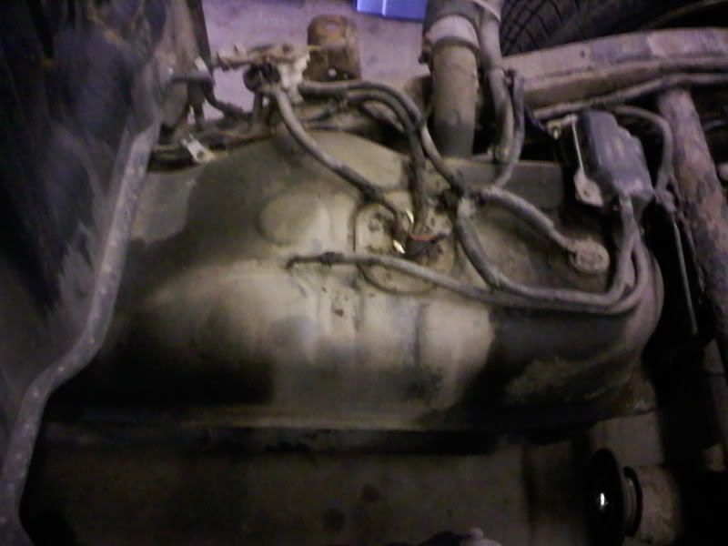

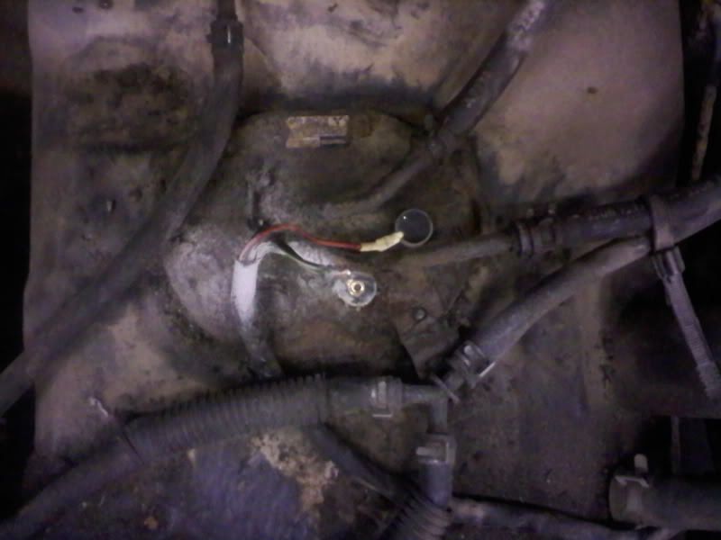

give you an idea of what your looking at... i had a leak in the metal line going into the tank (a sender line), and then a connection got yanked... so i had to repair a wire connection. my bed bolts didnt move the first time i tried... i tried 2 days in a row even striped one... dont do that... very bad place to murder a bolt head... so i started to drop the tank, but couldnt see what was going on with all the lines and wiring up top... thats why i had to repair a wire... i ended up saying 'f- it!' and tried the bed bolts once more and they came out.
