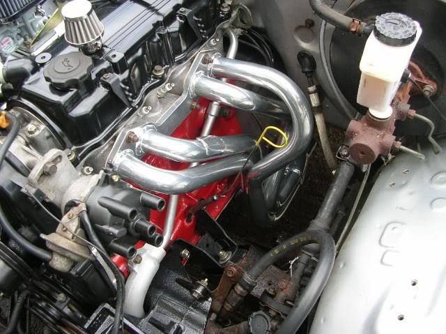

hawaiian
hers mine with auto trans.

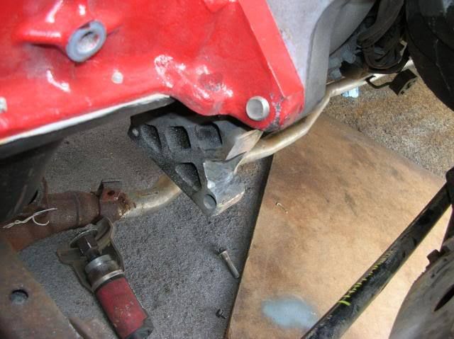

hawaiian
I cut a notch on the side. I think theres supposed to be an iron bracket that conects from the motor mount to the trans. I just left that bracket off and cut a notch on that bottom piece of the trans.
