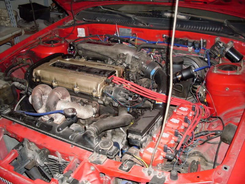

LA
low and slow
i dont remember if the fe3 is non-interference engine, but my point is
that the kia engine isent a real mazda fe3 engine its a diferent internals in the engine, not so solid i heard, if you gonna tune it,
the real thing 10-1 compratio 213hk on the wheels on 0.5 bar, now with a new turbo, and 1 bar of boost
and working great, until i was on the track and the rad fan, stopped working
91extcab's avatar
91extcab
is that in a b series? if it is it looks like its front wheel drive now? motor just looks like its sittin in the bay wrong...
