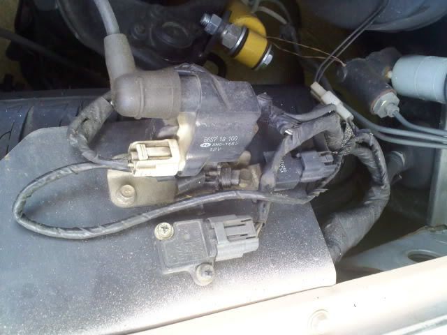

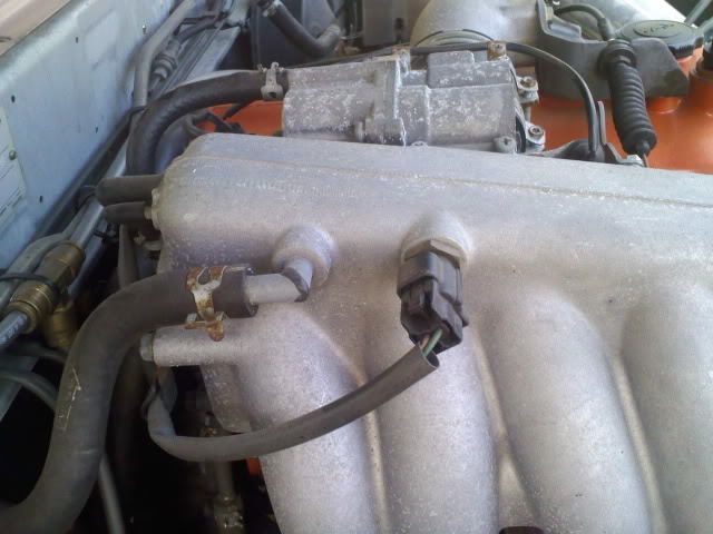

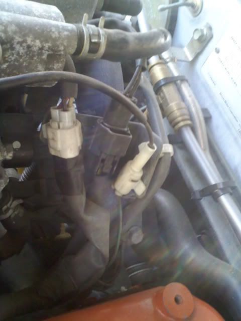

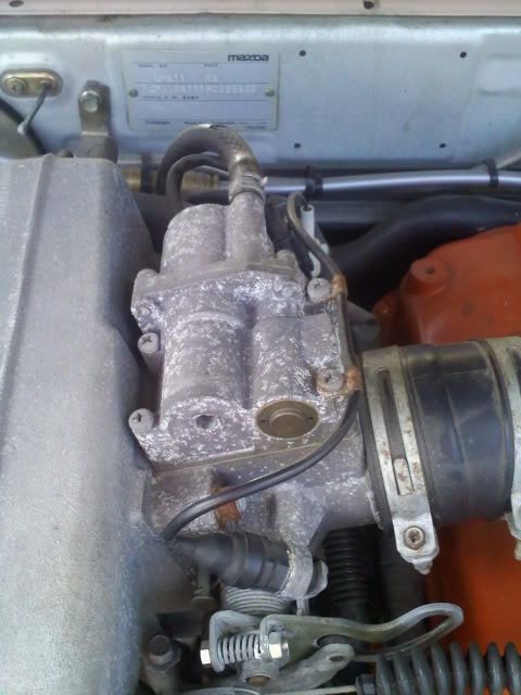

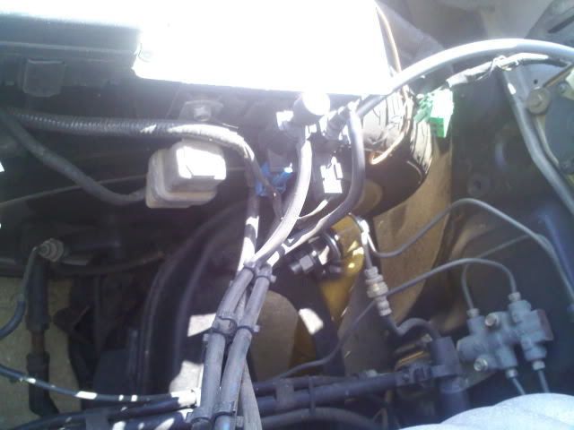

Pics of motor sensors....
mazdatweaker
Thank you for posting those pictures. . .
now please go back and do something with them. . .maybe resize them to 1/2 or something.
my computer / internet connection doesn't have a wide enough bandwidth to render them except in "post a reply / edit mode."
Do you have idea how many miles are on the parts you installed?
Have you done anything as far as checking for vacuum leaks?
The O2 sensor is in the exhaust manifold. Take a picture of it.
Take more pictures while you are at it.
Like one facing the front of the engine.
One of the thermostat housing.
One of the fuel injector rail.
One of the airbox.
Is your truck a manual or automatic?
Did the system come out of a manual or an automatic?
Take a picture of your multimeter, too.
Do you know what year the ECU came out of?
And if you could post the numbers off it it might be helpful.
