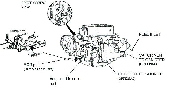

So today I went out to take a look at my carb to see if maybe I did something wrong when I put on the Weber. I found this diagram and it looks like I have the vacuum advanced switched on the side that EGR valve. The vacuum advanced plugged because I took out the EGR Valve.
Does anyone have it swapped like me or do you guys have it like the diagram? I thought you are suppose to have no or very little vacuum at idle and more when you accelerate. The one on the left (EGR side) has little or no vacuum. The other has a lot more vacuum. So which is it left or right?
Can you guys put up some pics to help me out.
hawaiian
plug the one on the left and vacuum line goes from the one on the right to the dizzy.

OK, I'll try that. But I'm still wondering how much vacuum are you suppose to have for the vacuum advanced? Or is that a silly question? Does any body know?
Aren't you supposed to have low vacuum at idle and more at acceleration?
