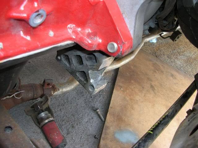

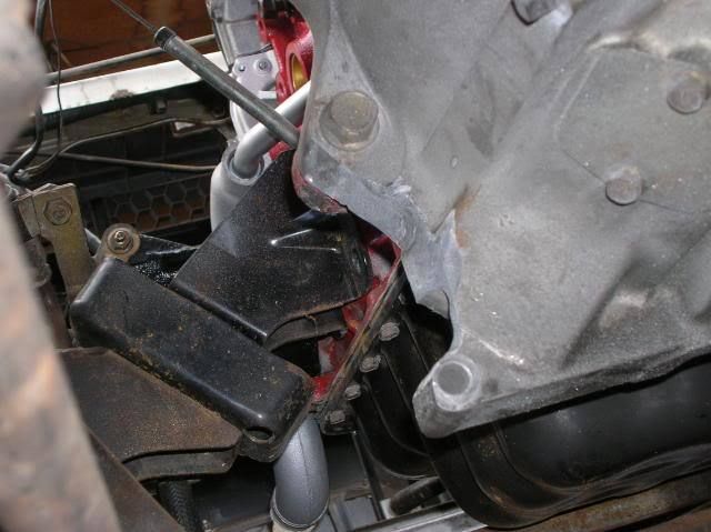

Heres where it needed to be grinded. I left the bottom hole so I can try and fab the bracket that goes from the block the tranny and have at least one bolt on unless someone can comfirm that I dont need to put it back on. I little more grinding than I expected. Kinda a tight fit but it works. forgot to take a pic of the spacing after I installed it. Ill get that pic up later.
