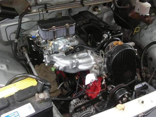

hawaiian
I have a weber and an auto tranny. My headers just came in last night so I should be starting her up this weekend. I took out all my emissions crap. I pluged all the wires for the tranny back cause I didnt know what they were for. cant really see them anyway so I just left them. theres only one vacuum hose on the rear of the intake manifold that needs to be connected to the tranny. The other two vacuum lines will be for the brake booster and the dizzy. I didnt know if the tranny had connections with the ecu so I thought Id cut the rest off little at a time after I get the truck started.
pimpz26's avatar
pimpz26
I just don't want to go removing the computer only to find that my trans. won't shift or doing something crazy like that.
BTW, yur engine looks good.
