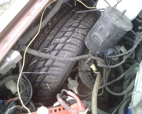

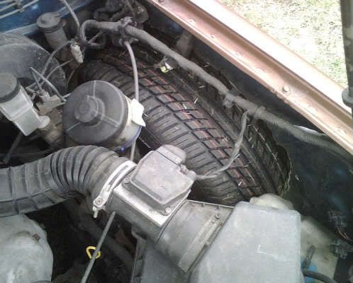

hey guys i need some ideas on how to straighten up this mess i cant always use the zip ties and bailing wire.
passenger side
Driver side

lol iam in the same boat.i know one way to clear up the passanger side is to get a weber carb and then you can remove all crap on that side. but i dunno bout the driver side.

Can you not get rid of the emssions even without the webber? I always thought you could.

no im just looking to tie stuff down so when i drive it will not get rubbed off
dvsdev
If room permits you could get some sheet metal and make up a channel for it to sit in, 1-1/8" wide top and bottom and 3/8" high, made like a "C" shape, run it under the guard, (following the contour of the body) and rivet it to the guard itself, strip the tape off the wires, remove any that aren't used and push the kept ones into the channel, hold in using another bit of sheetmetal folded into a "L" shape and either rivet or ziptie to the "c" shaped part.
I'd predrill the whole lot to be safe and use rivets myself.
The view from the end would look like a box section with all your wires running through it, the reason I'd do it this way and not just use box section is that you can't get the plugs thru the box section, and if you needed to run more it's easy enough to drill out a couple of rivets.
Or if you have a lot of time you could cut the wires and extend them to run along or thru the chassis frame, this could be hard to fix though if you damage the chassis using bags.
