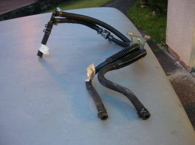

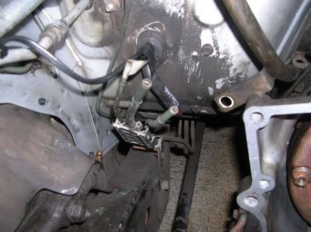

Gonna be installing a weber carb but dont know what to do with my fuel line(s). I have 3 lines coming from my gas tank. There were 2 lines T'd into one on the stock carb. Do I just keep it the same or can I just run one line?
Whats that round thing in the middle?
hocbj23
inline fuel filter.one is the delivery line , one is the return line from the vapor trap( the big black cylindrical thingy on the passenger side fender well) and one is the overflow line from the stock carb (the Teed one).I guess u can run just the delivery line iif u dont mine gas fume smells emanating from ur engine bay.I run a Weber but I kept the vapor trap and return line-I dont like gas fumes.bj

Uhh...ok, I'm lost. In the engine bay pic, the left line went to the vapor canister. The one in the middle and the one on the right was teed into one line that went to the carb. That little round thing doesnt look like an inline fuel filter at all. In the hose pic, the two lines went down and the single line with the T went to the carb. The metal bracket was mounted were the mechanical pump would be. So should I just keep it the same way minus the vapor canister? I think one is supposed to be a return line for fuel injected models?

oh ok you dont have a mechanical pump. yeah just leave the two t'd together and run to the carb. mines mechanical so mine is different.
