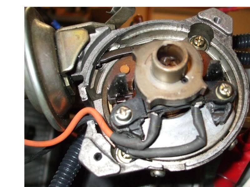

Ok here are some pics. If i was hooking up a msd box i would do it this way. I think the stock brains on the mazdas dont like the extra spark.
This is what it looks like when its done. Notice the spacers under each side of the pickup i broke those off the end of the brains so the pickup was spaced right.

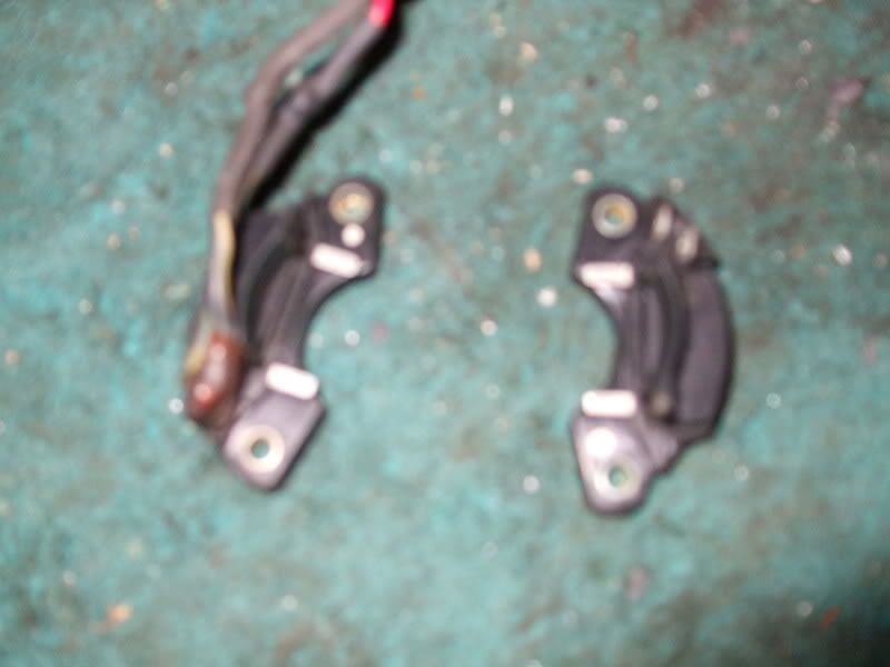

Here are 2 dead ones that i tore apart for pics. See the 2 contacts coming out of the brain those are what you need to get.

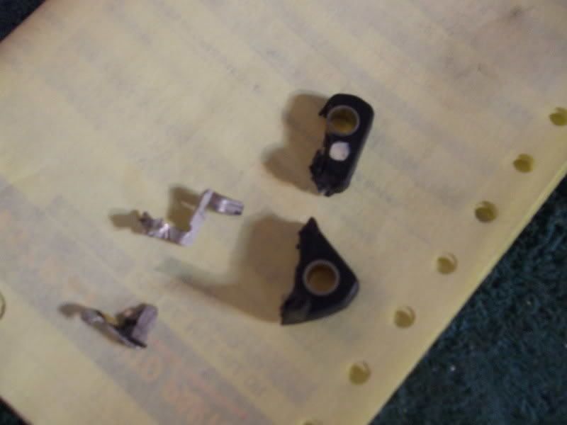

Ok here is what is left of the brain notice how the contacts turn 90 deg so be carefull when breaking them out of the plastic. Then i soldered wire to then and put heat shrink on them. The orange wire that i used goes to the purple pickup wire and the black goes to the green one.

The mag pickup is in the dist. The orange and black goto the purple and green pickup wires coimg from the msd box. They should be a short set coming off the msd box with a plug on the end. Those only get used is using a msd dist with mag pickup OR if you modifiy your dist to be run as a mag pickup wich is what i did so now i use those 2 wires. It makes it a better pickup than using the stock brain in the dist. If you bought the msd new there should be a jumper in there for doing this, it has the plug on one end then about 4" wire and 2 spade connectors. I have the stock type setup on my other mazda with no problems, i left the black box hooked up on that one and i run a msd coil. The msd box might be a bit much for the stock coil!
