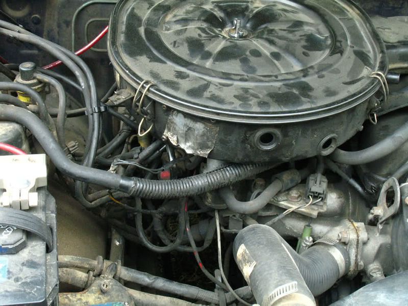

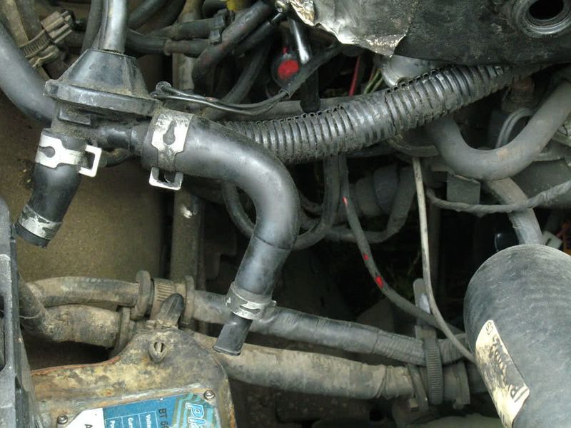

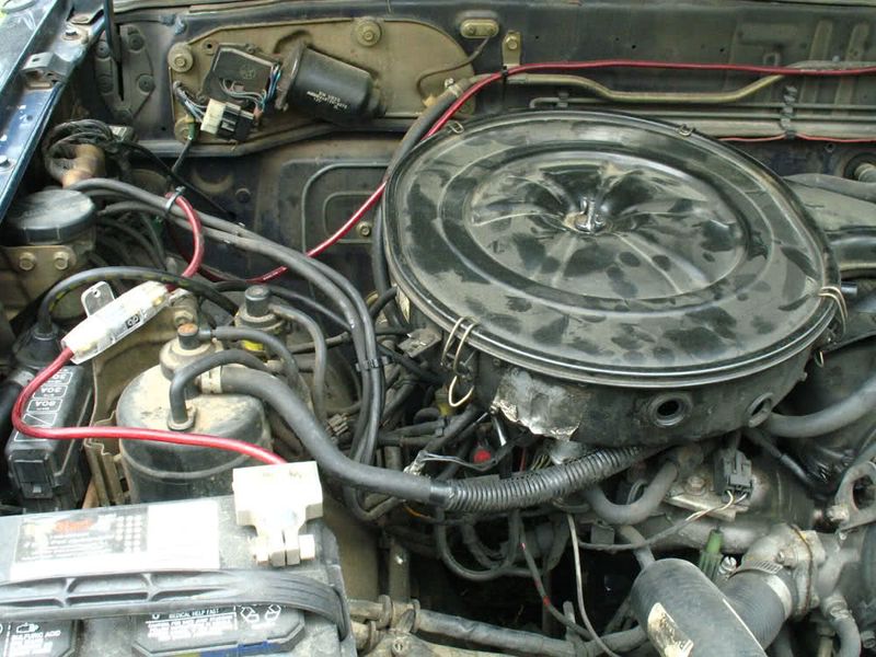

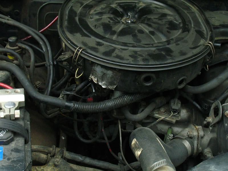

I was tightening my belt on my B2200 last night and i realized theres alot of crap under my hood.
Alot of the vacuum hoses to the left of the air cleaner arent even hooked up. Tried unplugging a few more and unplugging them does not effect the way the truck runs/idels etc... no CELs either. The box thats supposed to be on the front of the air cleaner isnt even there anymore (previous owner did away with it) Theres just a huge mess of useless vacuum hoses and such.
Heres some pictures.
Again , i'm no concerned with passing inspections and such. I would like to remove as much junk out of there that i dont need.
excuse my very dirty engine bay

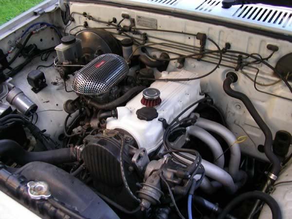

I got rid of most of the junk around the motor and still have the stock carby, I've been driving around like that for a few years now.
My engine looked like this
It's alot tidier now though, I've removed most of the junk that I could around the block, relocated the fuses under the battery tray, shifted my air horn pump to behind the grille, blanked off the unused hoses in the inlet manifold and cut and removed unused wires wherever I could.
Currently i'm deciding if I should remove the fan and fit a electric one, you can never remove too much unused junk.
If you do start stripping stuff just don't forget to block off hoses, I went to the local wrecker and got heaps of those little rubber caps, didn't cost me anything and looks better than a screw in the tube like I have seen.

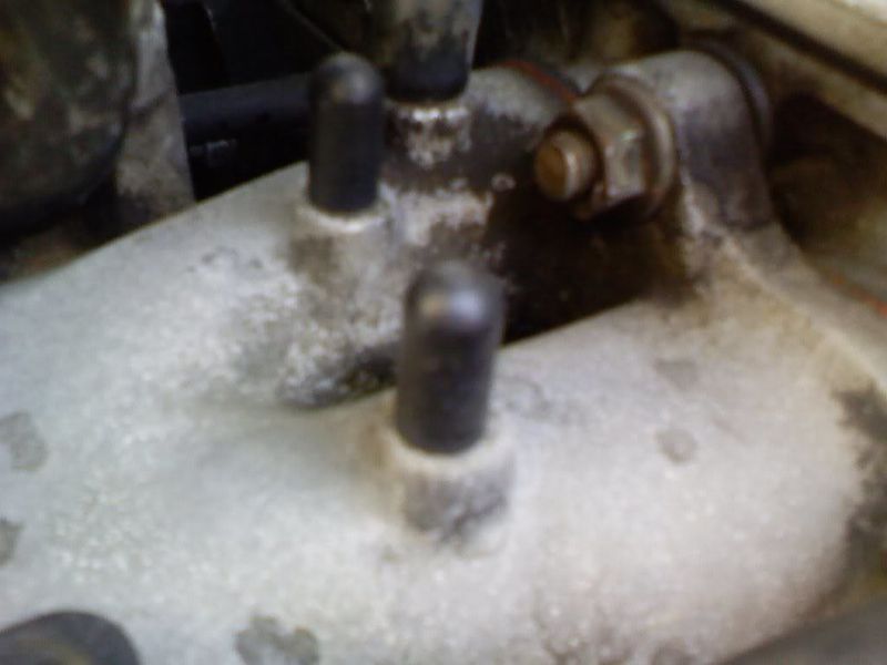

Sorry I took so long, I couldn't find my camera so I took pics with my phone then realised I couldn't find my cable i carefully put away in all my careful tidying I did recently... ok I lost it.
Anyway here's a blurry pic of said caps (I think my phone had beer goggles on looking at them now), they just blank off vacuum inlets, looks much tidier than most other ways (except filling with solder and filing smooth)
I'm pretty sure they come in various sizes too
