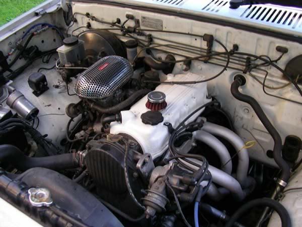

Hey man, I've got extractors made with 1 1/4" primaries, joining into 2 1/4" exhaust just under the cab, no cat into a ugly muffler from the exhaust shop then 2 1/4" over the frame and it comes out in front of the lh rear wheel, sounds pretty good for a 2ltr truck motor.
Had no problems with the cops with noise, it has a slight rasp if I really thrash it though when it gets up high in the revs and pops on decelaration if in 2nd or 3rd going downhill at too high a speed.
I'm pretty happy with my system.

Sorry we sometimes call things different things here, my "extractors" have a flat flange bolted to the block then 4x 1 1/4" tubes run from each cylinder which then join into a 2 1/4" at the bottom of the firewall.
here's a pic, hope it helps
Power seems to be up over what was on there before (1" pea shooter) , and since it leans out the motor a bit you usually get a small increase in power, I haven't had it dyno'd though (as them laughing often offends)
