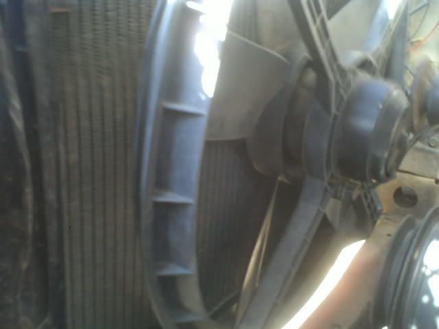

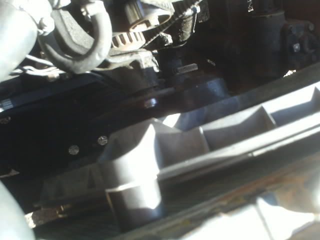

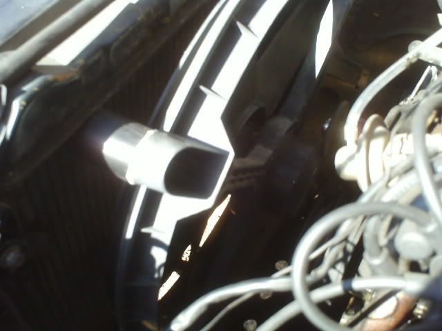

I just got mine finished, I got a 16 electric fan out of a friends camaro, went to O'rielly's and got a electric fan thermostat. Wired it in the way the diagram show, and works great. Fan kicks on at about 190 and off just under 180. The thermostat was around $30 I think. I'll try to get some pics up later today. Oh and if you don't go with a thermostat, which just about everyone I talked to highly recommened it, you want to wire it in using a relay. Like I said I'll post some pics later after I get some sleep.
oicu812's avatar
oicu812
Now that I got out of bed and got the girls fed, ha poet and didn't know it. Sorry back to mazdas. Here are some pics of my 16 incher
If you look closely I removed the pully, the whole reason for the electric fan is for less pull on the engine so I wanted to eliminate that from the belt loop all together.
At the same time I installed the GM one wire alternator and wow what a diff. I can actually come to a stop with the defroster on, head lights and stereo and it won't try to die on me.
And I made the brackets for the alertnator so I didn't have to do any cutting and griding on the casing it self. Let me know if you need any more pics or advice. Hope it helps

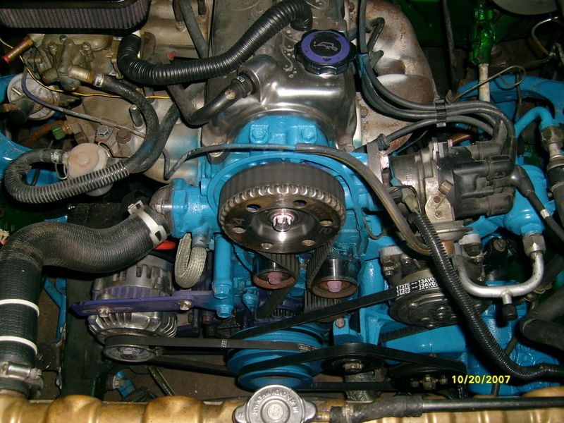

Thank you for the pics. That is what I'm looking to do. I have a question about the bracket that you have on the first pic. Did you just remove the pulley? or did you remove the bracket in the pic later? I want to do this to my mazda and just wanted to get some opinions. thanks again
F
futrao
he just removed the pulley if u want to get rid of the bracket where the pulley mount u gotta cut it off cause thats the alt bracket aswell i started to do this mod today i'll post some pic tomorrow aswell

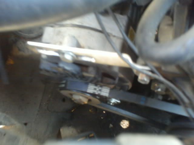

Don't know if this will help answer your question mazdamagnumgirl, but I think this is what you are after.
mazdamagnumgirl's avatar
mazdamagnumgirl
Yes that is what i'm looking to do. Thanks for the info and the pics . I want to tell my fiancee who had doubts about doing this kind of mod. Thanks again
