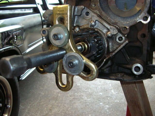

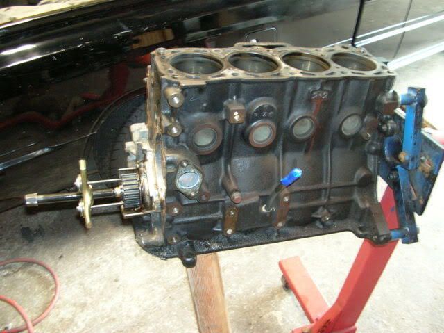

hawaiian
Ok, I finally got it off! Heres some pics of the puller I used.
Post was last edited on Feb 04, 2009 10:22. Edited 1 time.
mazdatweaker
post deleted
Post was last edited on May 13, 2009 03:01. Edited 1 time.
hawaiian
Sorry, pics should be up now. I sugest not useing anything to pry it off. The edge of the sprocket is fragile and cracks easily. The price for a new one is between $20 and $30 dollars.
