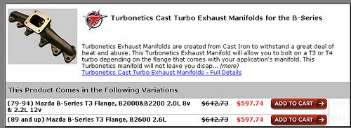

I saw this last week while i was looking for a new clutch. Not much info but a start.
castaneda8's avatar
castaneda8
damn thats hella nice but also hella expensive lol
