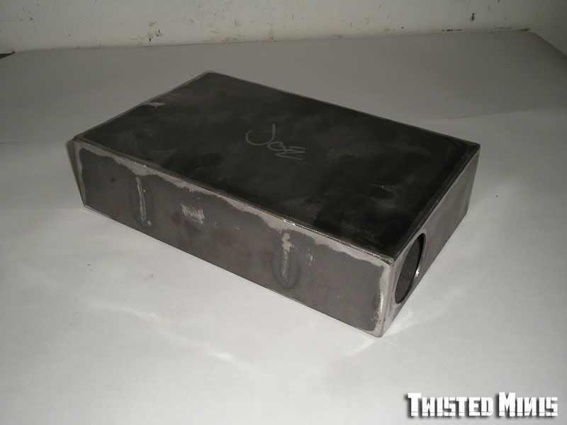

Some turbo mufflers are louder than others. The tine ones are usually single tube, and pretty loud. I took some big ones off a guys truck, and they sounded pretty good and not too loud, but he wanted some 40 series. I got to keep them, so I cut them apart. I took the design, and put it into a smaller compartment. So now I make my own! Lol.
Here's some sound clips.

Bagged - would be interesting to hear how those sound!!! Twisted - I did end up building one of your turbo mufflers with some fiberglass in the middle chamber. Sounds good! And considering the size of these engines I can't see how there would be excessive back pressure. Will try to get a sound clip one of these days once I get it out of the garage. Again, Thanks Twisted for the idea and info.
