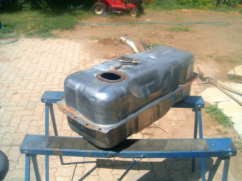

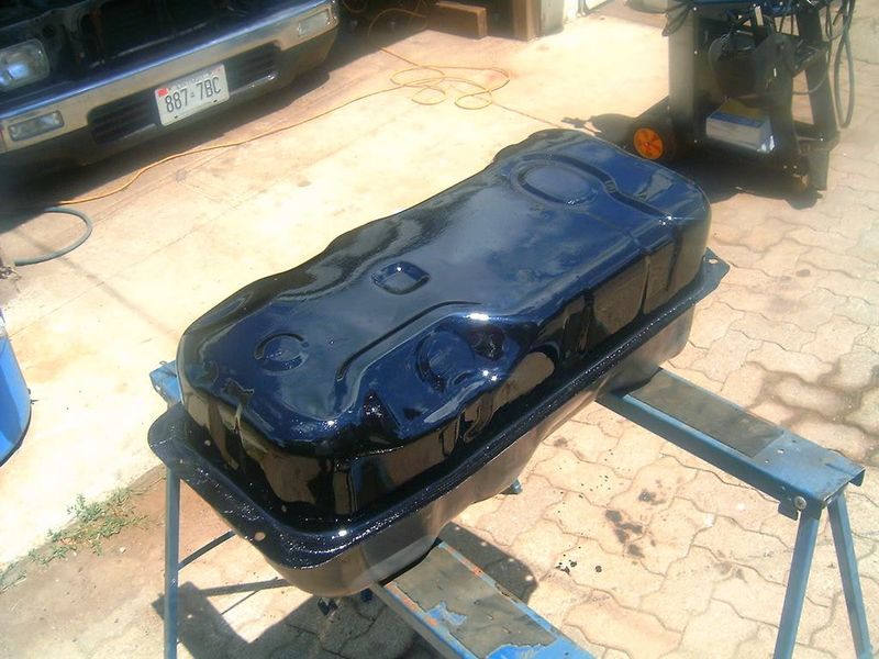

Stop do not use under coating. Use POR 15 for your tank I used it on CID's gas tank and this stufff works alot better. Here are a few pics of the tank before and after.

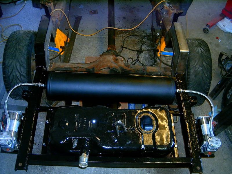

Here it is in the truck fully painted in POR 15
I will tell you that undercoating will not take the abuse that POR15 will take and this stuff will not come off it you get gas on it.
