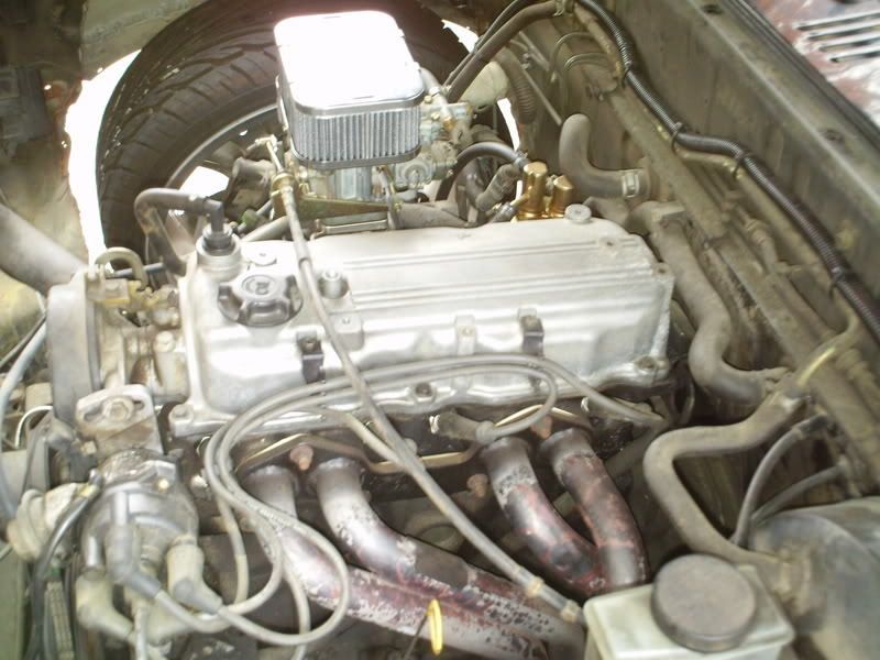

ok can someone pm me or something. i'm havin a hell of a time with this. i have no problems with my chevy's but this is the first time i've done this on a mazda. anyone have a good LARGE picture of the engine bay with a webber?

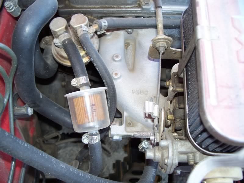

frontierguy
I have plenty of pics of mine. Let me know what you want to see.

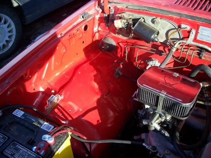

dragginmazda86 (dave)
Heres the best pic I have of mine. Almost all vac ports on intake blocked and egr blocked off, all wiring for emissions removed and ecm removed.

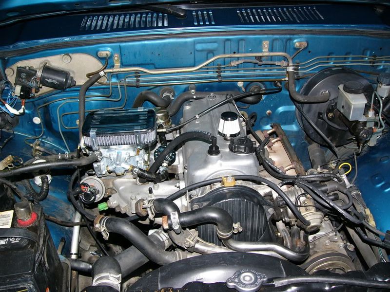

heres another angle.
