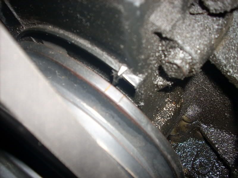

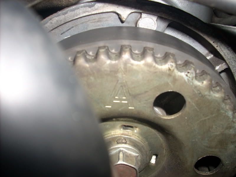

ok Im doing the timing and I have a question. There are two marks on the crank pully, which one do I line up the cam sprocket to? Where it is at in the pictures it lines up with with one of the marks on the crank pully but not sure if it suppose to line up to that one. The #1 piston seems to be a TDC but than again its close if I turn it to the other mark on the crank pully. I have not adjusted anything that is where it is at when I opened up the cover.

ok if thats fine, what else can I check for? The noise sounds like something is hitting inside the engine.
