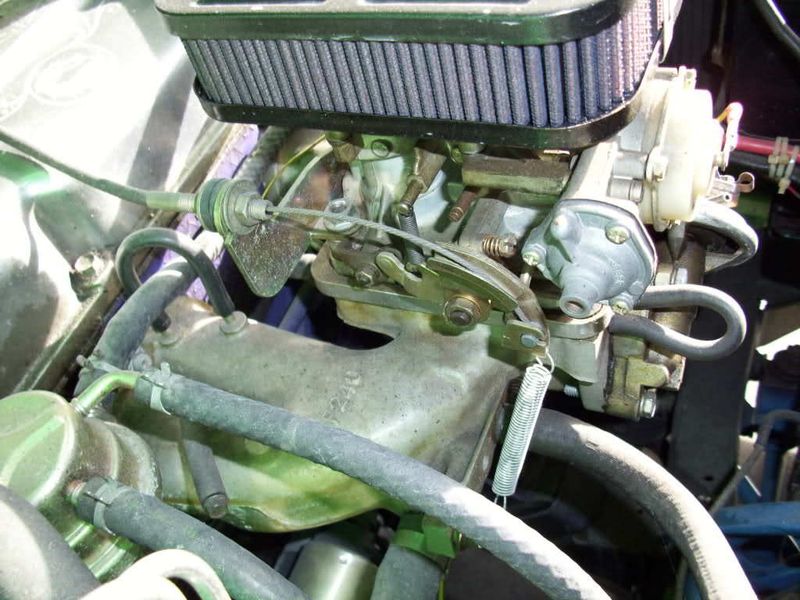

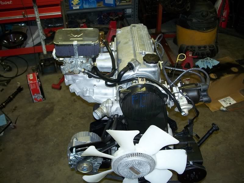

i took the intake off and i want to clean and paint it befor einstalling my weber ,does anyone have good pics of what i need to plug up and what i dont need ?post some pics please
NO!!...lol
tre5
plug every vaccum line on the intake manifold. the only vaccum line still needed is the one from the carb to the distributer.

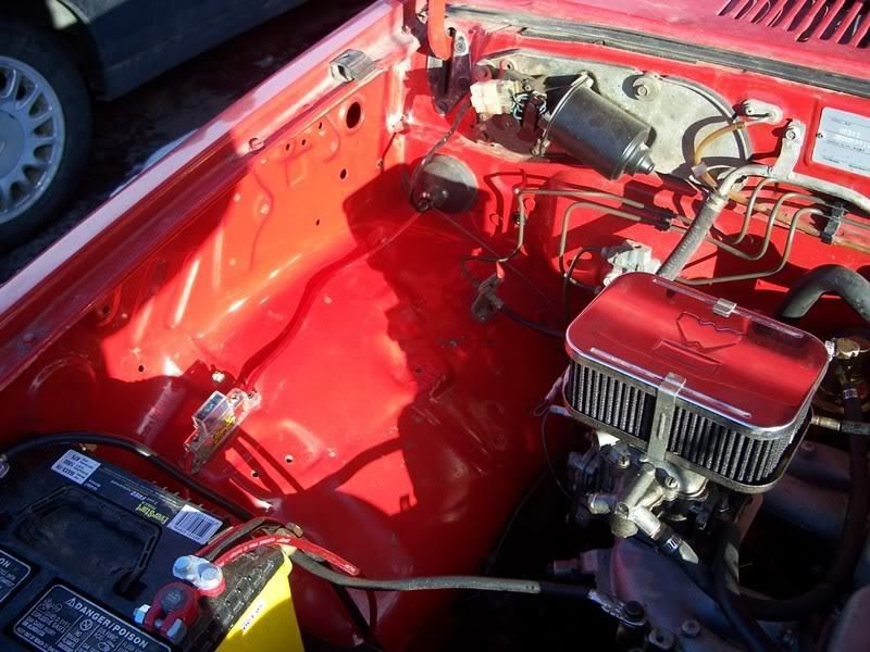

These are the best pics I have right now. Hope they help or I cant take a couple more tomorrow if you need them.

why is there a ground ,going to intake is it a must,also can you pease take more pics from different sides
tre5
You don't need that ground wire. The stock ground is fine for the battery and motor.
dragginmazda86 (dave)
The reason my ground is there is because the cable was a bit to short to go any where else. I took a few more pics but wont be able to post them till I get home.

ok kool ,also do i need the egr vavle on the intake cause some people look like its off ,and i was told you will get pinging if you take off

You can take the egr off and make a block off plate for it. I havent noticed any difference with or without it
