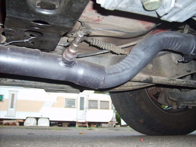

the o2 senor should go on the flange pipe.
well mine is anyways.. i have the header to the flange pipe to another piece of pipe thats 12" long and then my glasspack muffler..

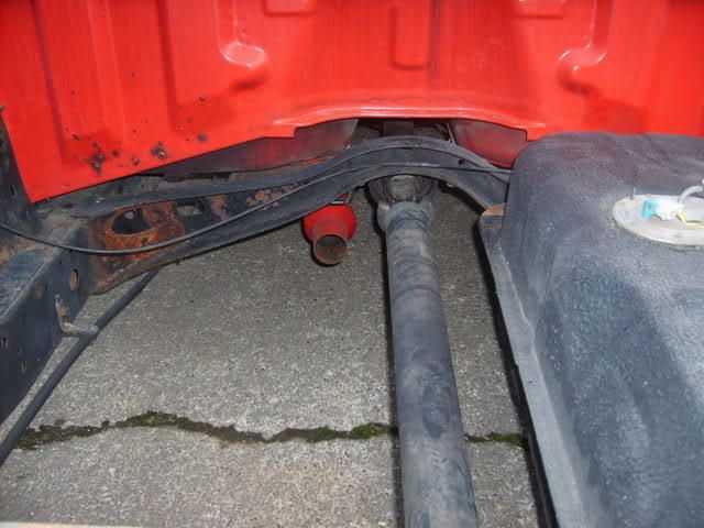

lets see... i'll go and get ya a few pics!!
give me a min
91b2200(cody)'s avatar
91b2200(cody)

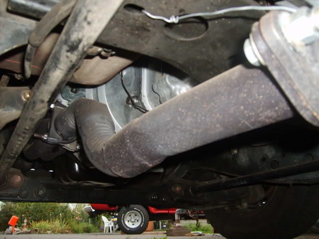

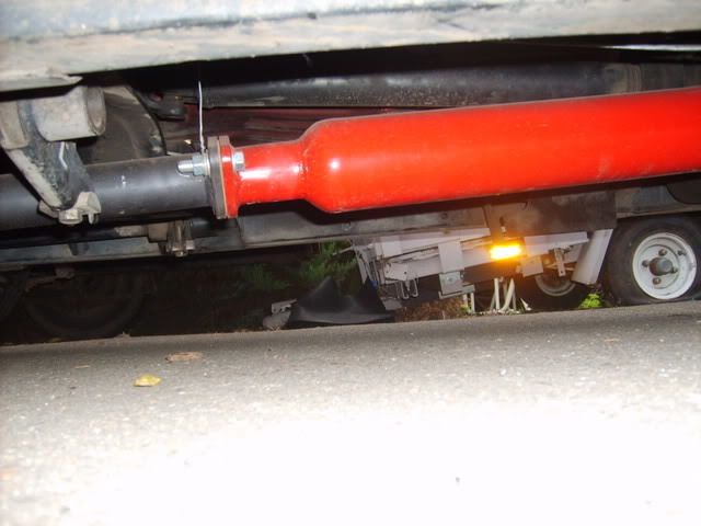

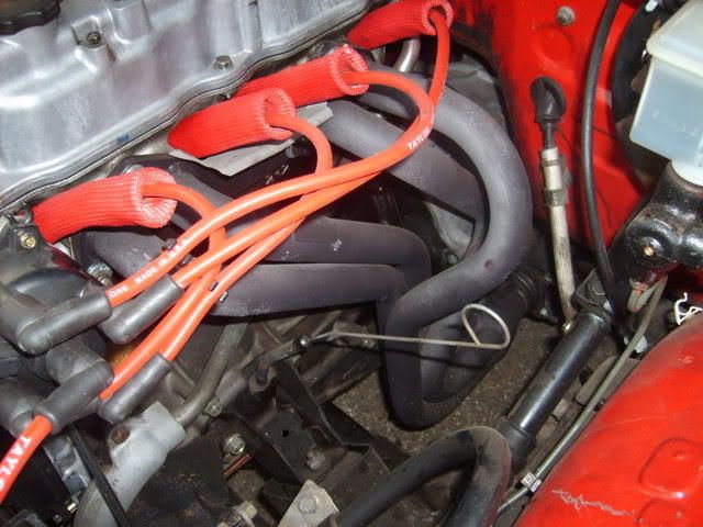

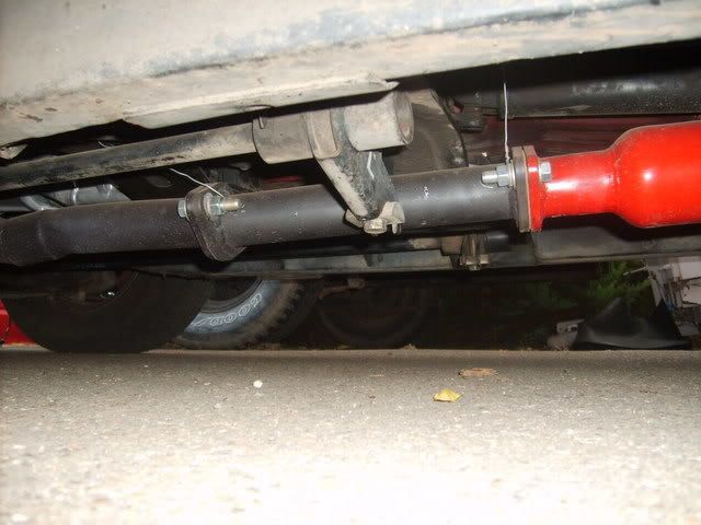

okay heres my entire exhaust system..
-red hots glass pack
-pacesetter header
i bought the header used from a guy so it may look different (the flange pipe that it) ..
tre5
see how you have a bent piece shaped like a S? Thats what I am talking about. I guess I shouldn't complain at least it doesn't hang lower.

ya, is yours not like that ?
tre5
mine is like that. My complaint is that it should just be a little lower so that you don't have to bend a piece of pipe to go under the crossmember.

you don't need to plug the hole if you dont install that part. It comes seperate from the header. If you notice on Cody's truck they welded it on after the S-piece.
