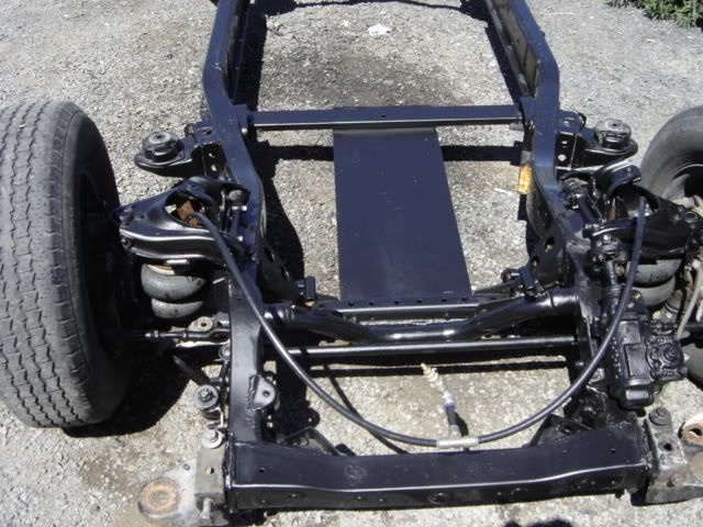

can use this to make the 4.3 swap into y 87 b2200
i guess im wondering if the mounting points on a small block 350 are the same as the 4.3 v6 out of like an s10. thanx in advance

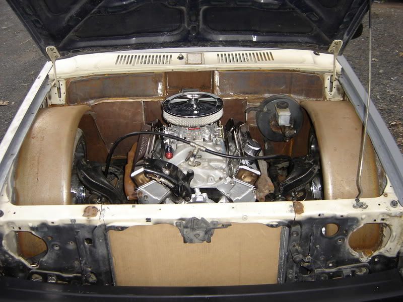

diferentone- that is the same croissmember I used to mount my SBC in my mazda I also got it from Summit. You need to get say 1969 camaro engine mounts to use that crossmember. Heres a pic of my mount, it is set way far back, yours would most likely be set more forward.If I did a 4.3 I would use the exact same mount.

oh and that 350 looks real good in there
