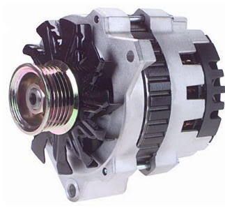

Ok i'm cunfused. I just got my Gm 1 wire from a guy and it has the CS130 Casing Style which is completely different from stock. Who here is atually running a 1 wire GM and who could give a tutorial on how to mount this sucker. I was considering flipping the alternator upside down and flipping the top bracket from end to end to do it but I don't wanna bore the bolt hole incase this doesn't work for me. Then i'm stuck with a CS130 140amp .
Here's a picture of what I got.
Is this the "1 Wire GM" everyone is using? It's the same style as a 10SI or 12DI or whatever those models are called.
Question is how do you bolt it up properly to the engine mount on the bottom?

So how do I mount the one I have in the picture I posted? The guy I got it from said he can get the same style casing as the stock one. I would have to drill out the top hole on the new alternator and flip it upside down and us the top for the bottom mount right? The only proplem I can see when doing that would be that the top bracket would be awfully close to the external fan on the alternator.
Marcus: Is the one I posted the one you have? Or do you have the stock looking alternator on yours? Once I get this in i'm going to do a write-up on how to do this so there's not 10 threads about the "1 Wire" .
