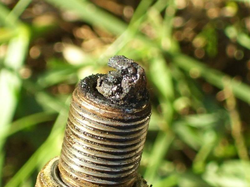

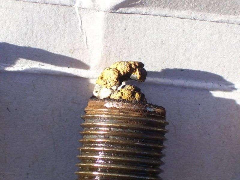

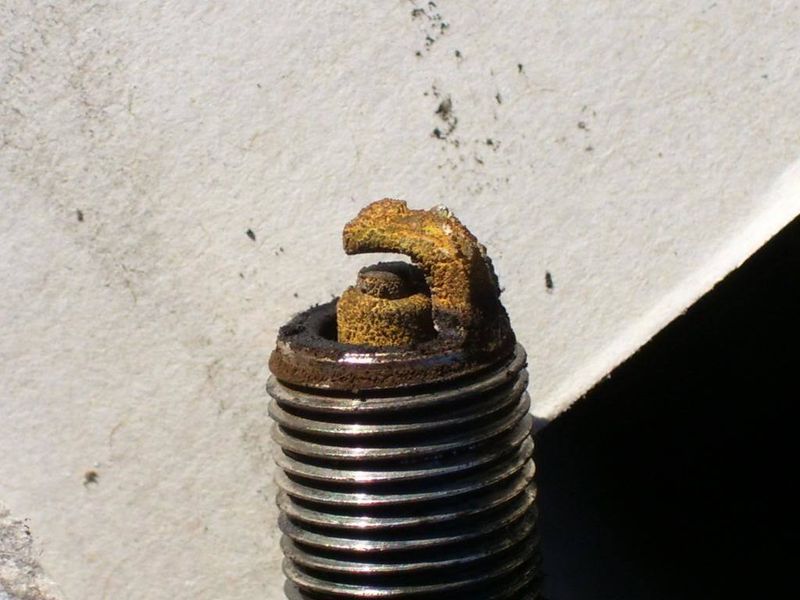

I think you'll get some laughs out of these pics. These are the plugs that were in the truck when I got it. Changed them back in September.

Oh no, That's exactly how my truck smokes. I was hoping it was just the head too. Could that be the rings?

The plugs that were in it when I changed the head were purple and green. They've only been in there since September when I changed them from the ones in the pics.

Mines white and blue and really stinks of oil, haven't checked the plugs yet

i dont think it would be the O2 sensor cause if it was getting excess fuel the smoke would be black in color. And i had a 89 that smoked pretty bad in the morning for a couple of mins but the smoke was definitely a blue color and the engine had lots of blow-by so it was oil getting past the rings until they warmed up enough and expanded. Does it go away when warmed up? although your smoke looks pretty white which leaves me to believe its coolant getting into the chamber, possibly a bad head, cracked or warped?
