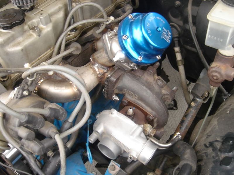

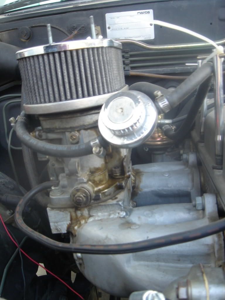

Heres a couple pics of a setup that a guy I know is building. I don't know all the details but I know its a Delorto carb that is modified to be pressurized, he modified the intake to accept the carb and to get rid all unessary stuff and get the carb lower for the carb hat. This motor is built!! He took me for a ride before he put the turbo manifold on and it's quick, cant wait till he gets it done with the turbo.
