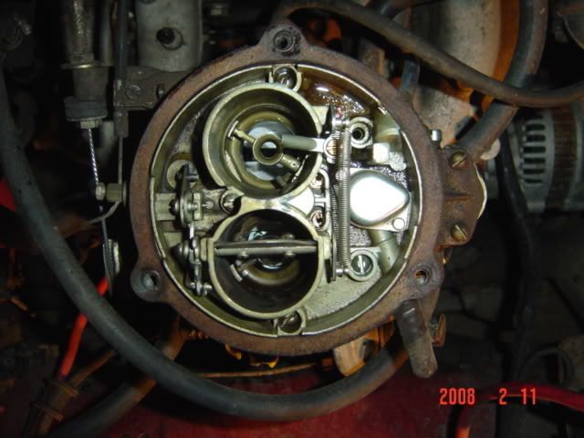

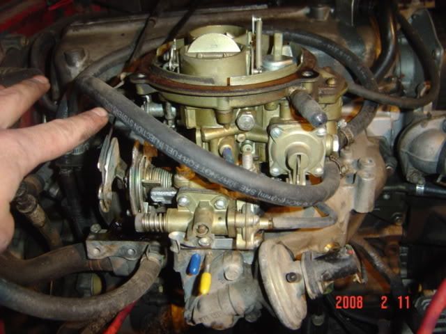

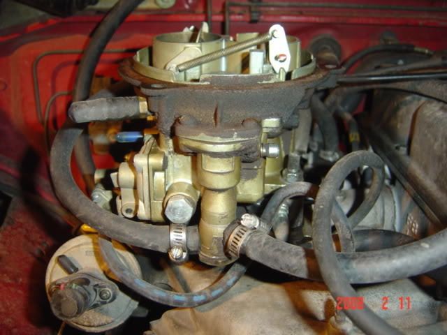

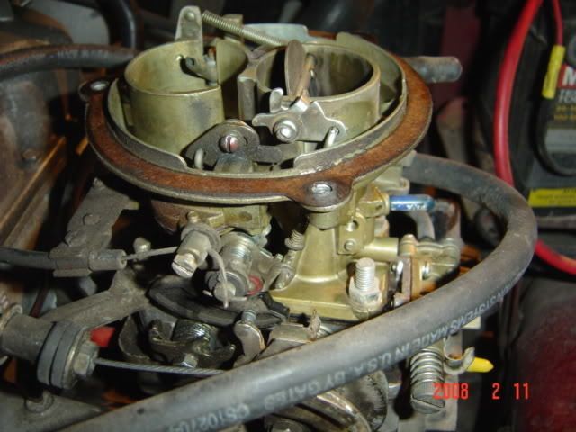

anyone know how to adjust these? i have had mine for about 3 yrs now and have had no problems but now all the sudden it is running WAY to rich. and i can't figure out how to adjust the fuel. there are 2 adjustment screws but niether one of them are fixing my problem. is there something i am not seeing? if i slow down it kills the engine and i have to crank it and crank it until it will fire back up. this is my daily and really suckin right now. i think i may have a blown o-ring or gasket or something and will have to rebuild it but if someone knows where i can adjust the fuel please let me know. thanks. i will post pics up soon of the carb.

passenger side where the 2 adjustment screws are...

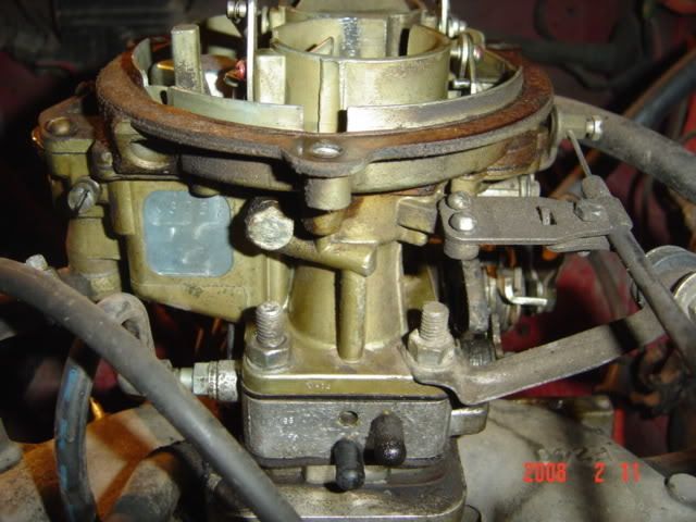

front of the carb where the fuel enters, there is a screw on top but does nothing when adjusted...
driver side (nothing)
back (nothing)
and the top

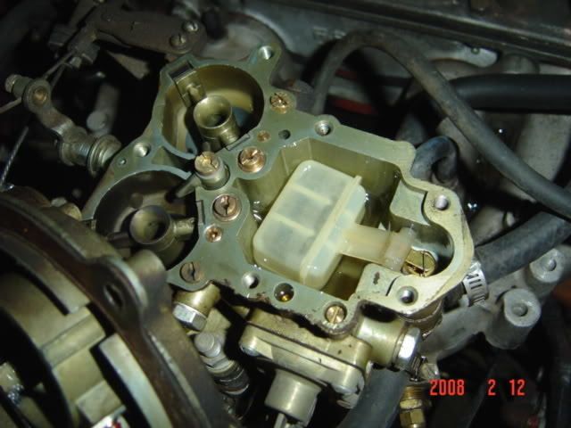

sounds like the float is getting stuck. adjustment screws dont just go haywire for no reason. check the float on it.

Ditto on the float that is why it still pours in when you shut it off!

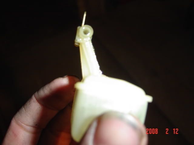

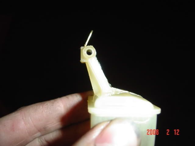

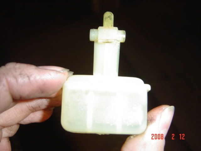

ok, the float is plastic and doesn't look very adjustable. there is just a small metal pronge on the end do i bend that how i need it or what? i have no idea how to adjust a setup like this. i am use to metal floats that you just bend when you need to adjust them. what do i do? there is no fuel in the float and it appears to be ok. please help asap, this is my daily. haha

well, i adjusted that tab and it seems to be running better. but it still ends up doing the same thing. wtf? i have adjusted it twice and the second time was pretty drastic. this thing has run fine for the last 3 yrs and now all the sudden it is doing this. i don't get it. i am going to try to adjust the float one more time but i don't think it is going to help. any ideas???

dropped90(justin)'s avatar
dropped90(justin)
a piece of trash in the jets will make it float to i believe. the only reason you will still dump tons of fuel even when its not running is the float getting stuck.
