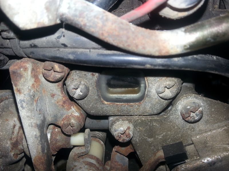

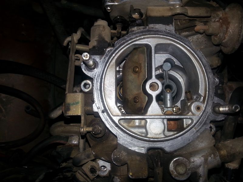

Well I managed to get the carb off and inspected it, sorta. The window on the front shows the fuel near the bottom, not half way up. I got to the float and it seems to be functioning properly, but I'm not sure what would cause it to be low like that. A few have suggested the needle valves are stuck or damaged. I don't know where that is or how to check though.
EDIT: here are some pics of what I am seeing, the one of the window is hard to see, but the level is very low. It is lower now that I have removed the bowl and poked around but before that it was at about 1/5th of the way up.
malachi1616
I dunno how it turned out for everyone else but when I attached those pictures they were all the same size and now looking at them one is huge and the other 2 are small... anyway the huge one I think is the most helpful.
