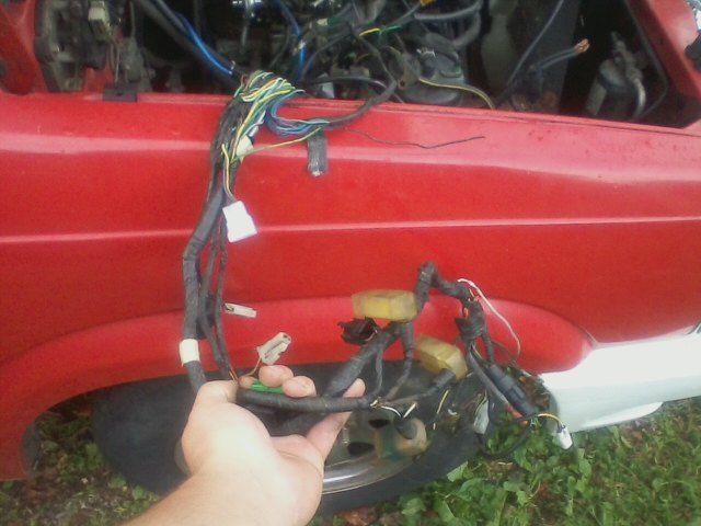

There is a load of vacume lines you can take off and plug and your truck will run better then with it all on. I'm looking through all my photos of my old truck and if can find them I'll post on here.

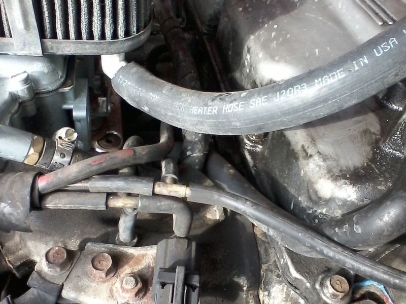

This is not the vacum lines. But some things that can be removed.

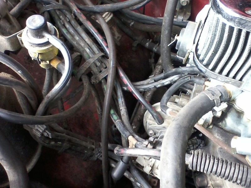

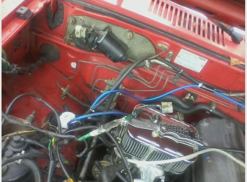

Not to double post, but here is what can be gone as well. This is my old B2200 i bought it with the weber on an thhese vacums an lines should be gone. Just one to your distributor, pvc valve if wish to keep it. Most of us slap a 4.55$ lil air filter in its place. And one to your evap canister.
And another of how not to use hosing, and a few others in these
can be eliminated. Sorry i cant circle particulair ones but im lookin for one after i cleaned my lines up
And this is best one i have of some hoses removed. Some may have better but hope these help.
