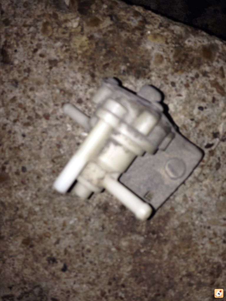

what is this?

No, that's not the EGR valve.

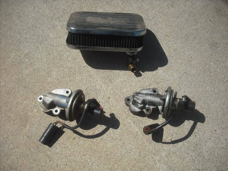

The EGR valve is on the right side of the engine (passenger side in USA), removed by disconnecting the harness and using a 10mm socket on the three hex-head screws, and if it sticks open or partially open, then the engine won't idle. Typically these can be removed and cleaned out so that the internal piston closes.
I've got two available, but check to see if yours is open or partially open, should release and close completely when vacuum is released. Here's B2200 EGR valves for carbureted engines:

I just wanted to know what that thing in the picture is
