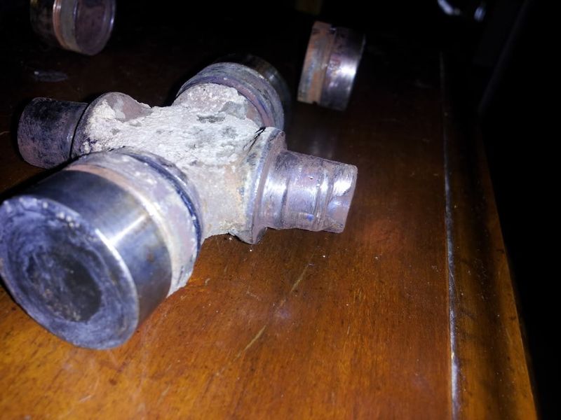

No its not u joints. I had one blow out on me before and trust me I now know the warning signs... Lol
As for your description of the sound it's spot on! For real that's exactly how it sounded before I replaced the u joints. I'm almost positive they are fine now.
here's a pic of the uj in question...
It was pretty bad thankfully it was the rear most uj and I wasn't going very fast...
I'll double check them tho and they're the kind with grease zerks so I'll just fill em up!
