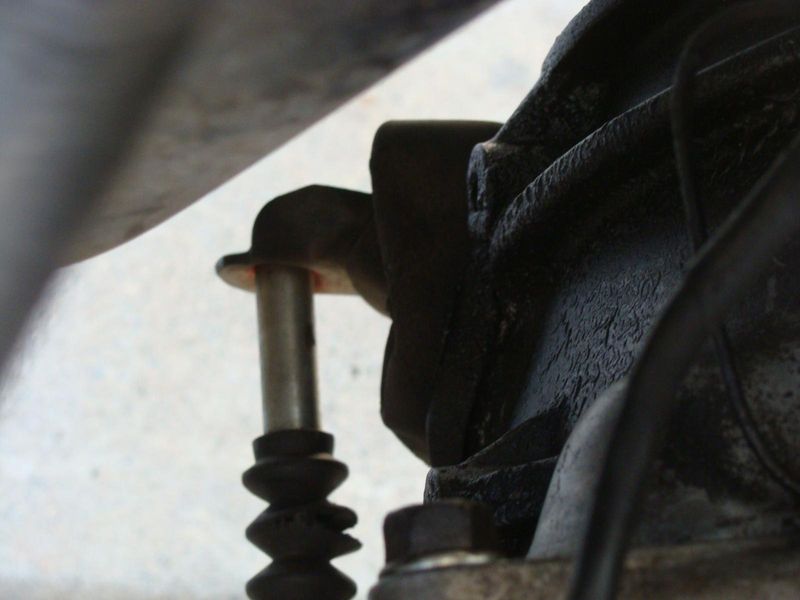

Rockin - have someone repeatly push in the clutch pedal as you watch to see if the slave cylinder is pushing the clutch release lever on the transmission as it should. That should help isolate whether the issue is with the hydraulics or inside the transmission bell housing.

But fist make sure that it's not just a slave cylinder thing not pushing the release arm far enough.
Any B-truckers near Rockin in Florida so he can compare with yours?
Maybe I can get some decent photos of my release arm in both positions.
Cusser's avatar
Cusser
I shot some photos this morning.
With pedal up:
With clutch pedal all the way down:
