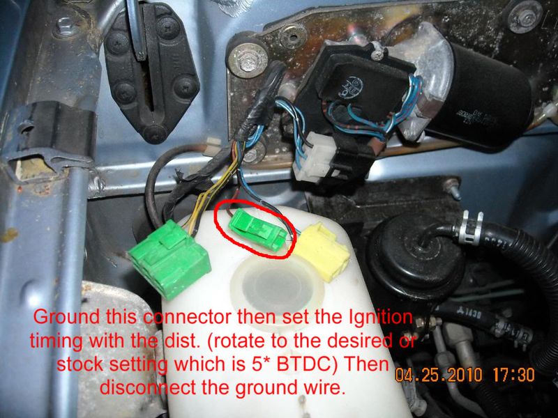

There are 2 green connectors......the single green connector is for setting the base ignition timing.......the other larger green connector is for other tests I guess. Here is a pic of all 3 of the connectors that are located near the wiper motor.
