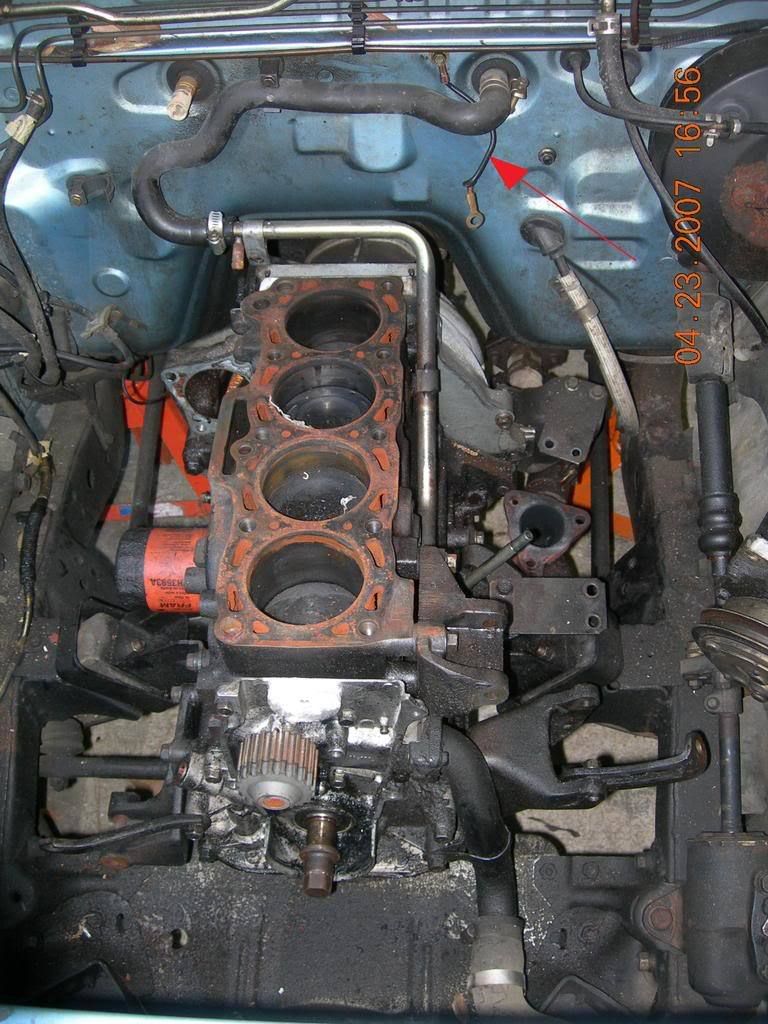

axel breaker earl's avatar
axel breaker earl
Do you have the large ground cable connected to the passenger side motor mount area, and is it tight?
Sometimes when doing an engine change you can forget to tighten things up all the way.
Also, there is a short black #10 gauge ground wire that goes from the back of the head to the firewall......is that in place and tightened?
Red arrow shows the wire.
This is connected to the rear of the head.....when the head is on the engine that is!
